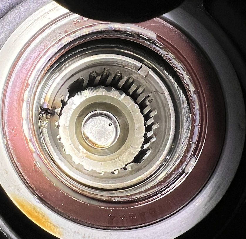

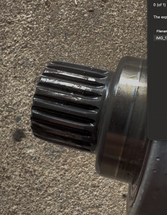

So, new here and have done a few searches but so far not found anything yet for a transmission issue I have. I have a 2007 4Runner with V8. After a hard stop all of a sudden a loud grinding noise form the transmission/transfer area. After pulling the transfer case the splines on the safe deff have one light damage to them, but on the rear od the transmission it looks like the female spline shaft is cracked. After pulling the transmission it look looks like this is just a spline coupler th connect the transfer case to transmission. But after calling Toyota they state this is not a serviceable part and does not have a part#
Trying to find more info on this part and diagrams with a part number but so far I have not been able to find any detail info about this.
In this pic you can see the cracked sleeve still on the rear of the transmission shaft
This is the shaft from the transfer case
Best I can tell from a few short vides on eBay is that maybe that coupler is really part of the transfer case and is supposed to have stayed on the transfer case but due to it breaking maybe that's why it stayed on the transmission shaft.
