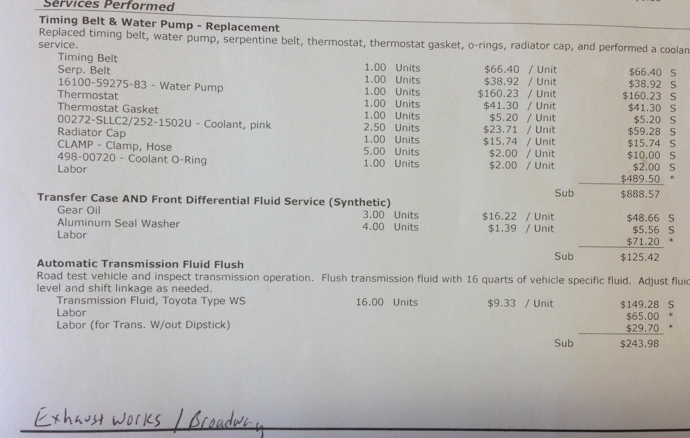

Hey marcus, what was included in that major service you mentioned?
Here is the receipt for the work--its what they recommend, and goes along with what I have read here and what the owners manual says.
