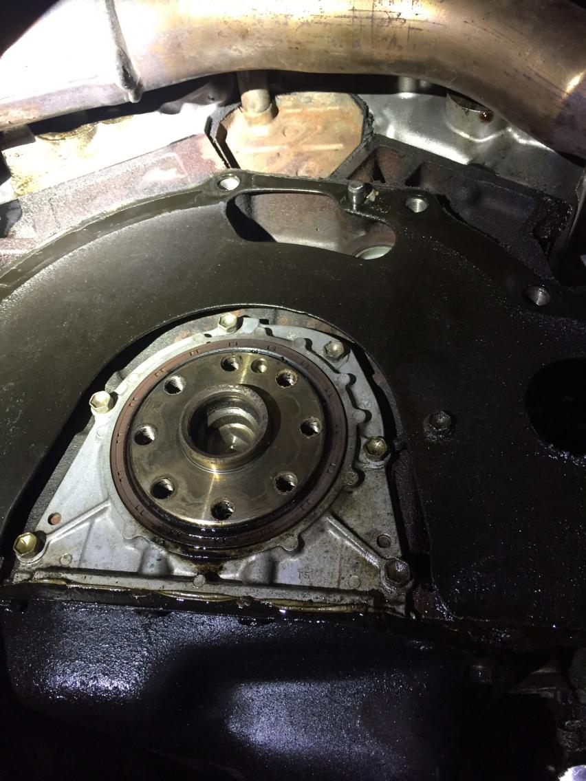

Got the rig back early from the shop. They received shipment of the transmission from Toyota a day early, so had it done for me Wednesday afternoon. So far all seems good driving it around town. I'll crawl under this weekend and give everything a once-over.
A special bonus of getting my transmission replaced is they did the rear main seal for me at my request. They gave me a photo saying it was "leakin' pretty good". That explains why my steering rack and other things have been soaked in oil. Nice to have that little peace of mind.

All in it was $3963.36 - if I had a garage and a second car, I likely would've endeavored this myself - would've been cheaper even IF I bought the OEM reman. That said it was financially bad timing and my circumstances led me to have the shop do it. I had them redo the rear main seal while in there and it seems to be holding just fine. As far as I can tell, they did a great job, and had the car back to me in 3 days, two of which were shipping days from Toyota.
