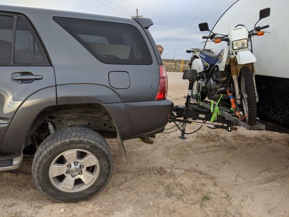

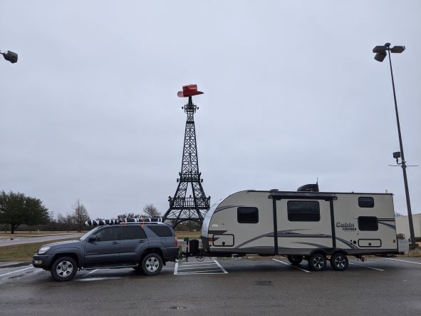

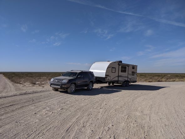

03 V8 limited 4x4 240k miles. We have towed 6000 to 6400 with a GV of 11200 or so for 20,000miles mostly out west including a lot up in the Rockies with no issues. we have new airbags, Bilstein 5100's, upgraded discs and pads and Yoko Geolander XL rated tires.
When we go offroad we are well over 7500lbs with water and supplies.
We make sure tires are at correct psi and sway bars are adjusted for load and conditions, we have driven in some pretty brutal cross winds in TX and UT we are really happy with how it tows.
For reference I have towed with everything from CRV to 3500 dually.
