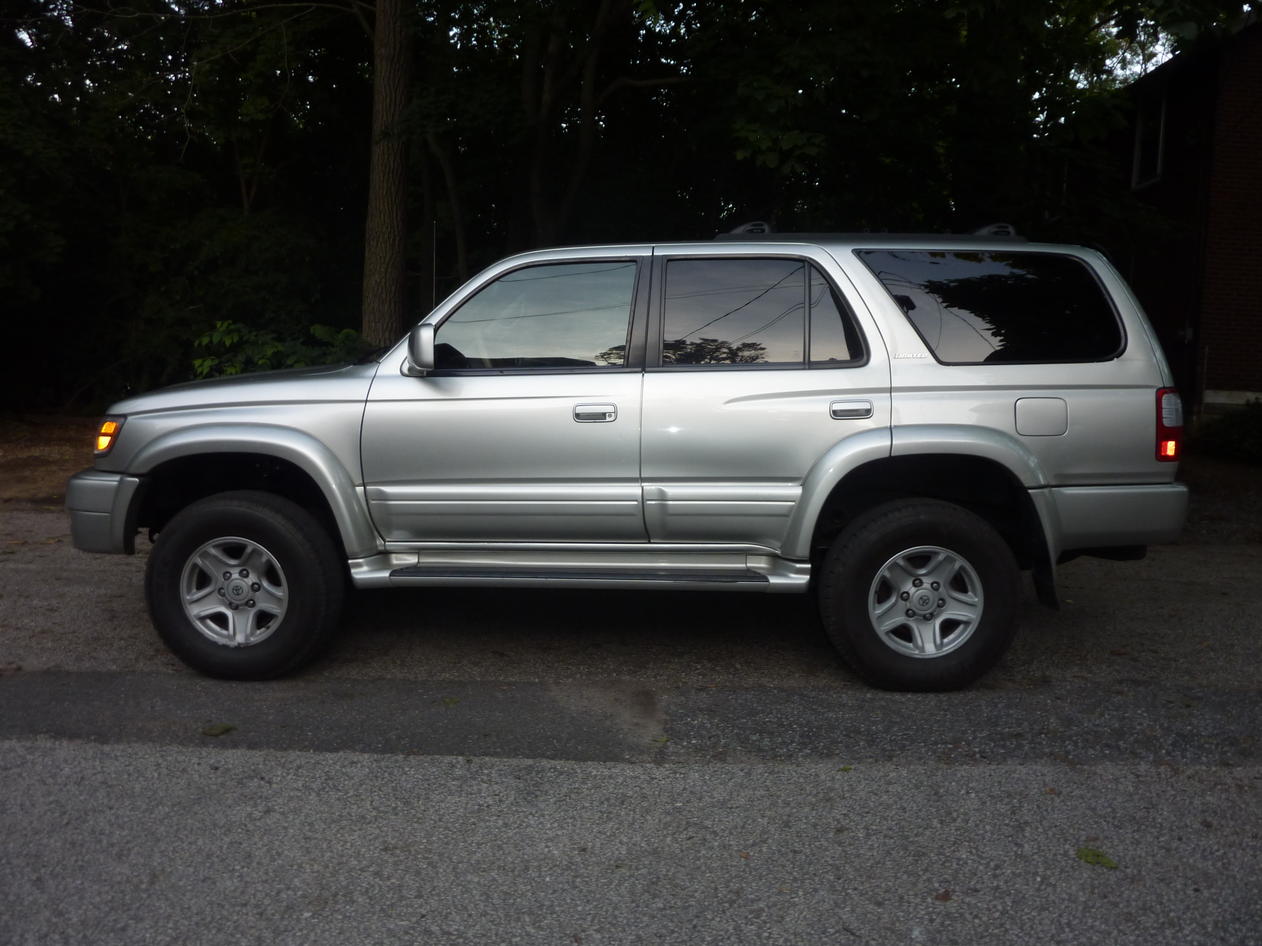

As an update for anyone that cared, I tore these things out and dropped them down a perch. I'm now on the first perch and sitting at 23.5 hub to fender. Got rid of the vibration, but still have some noise. Gonna run it for the winter and do some more digging come spring time when I can afford to have it down. Thinking perhaps the front diff drop has the diff sitting on the cross member.
You were at 23.5 on the second perch, so why was there no change? Each of the 5 perch settings should drop the lift about 2/3 of an inch. I have a 1 inch dif drop. Here's a pic of my truck with the same lift, same exact components. I'm only at 22.5 on the second perch and others have posted similar results in the front with the TRD tundra springs and Tundra shocks. Maybe you could take a tire off and take a couple of pictures of the entire coilover- UCA- LCA- spindle asy from different angles and maybe someone could spot a discrepancy.

I have 6500 miles on my TRD/Bilstein setup and just noticed a noise from my front end as well only on the highway. I am guessing its a wheel bearing because my CVs angle is 100% fine and they are not ripped or leaking at all. I am on second perch too.
