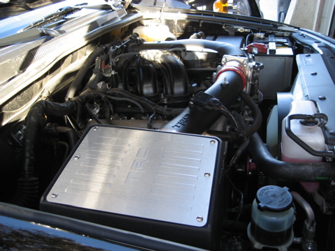

beirish said:
here you go... please excuse the dirt, engine bay needs a good 'gunking.'
Could you post a picture with the box opened, so we can see how filter is located there?
Is there any chance you can measure the box too? I'm wandering how big is it (outside dimensions).
