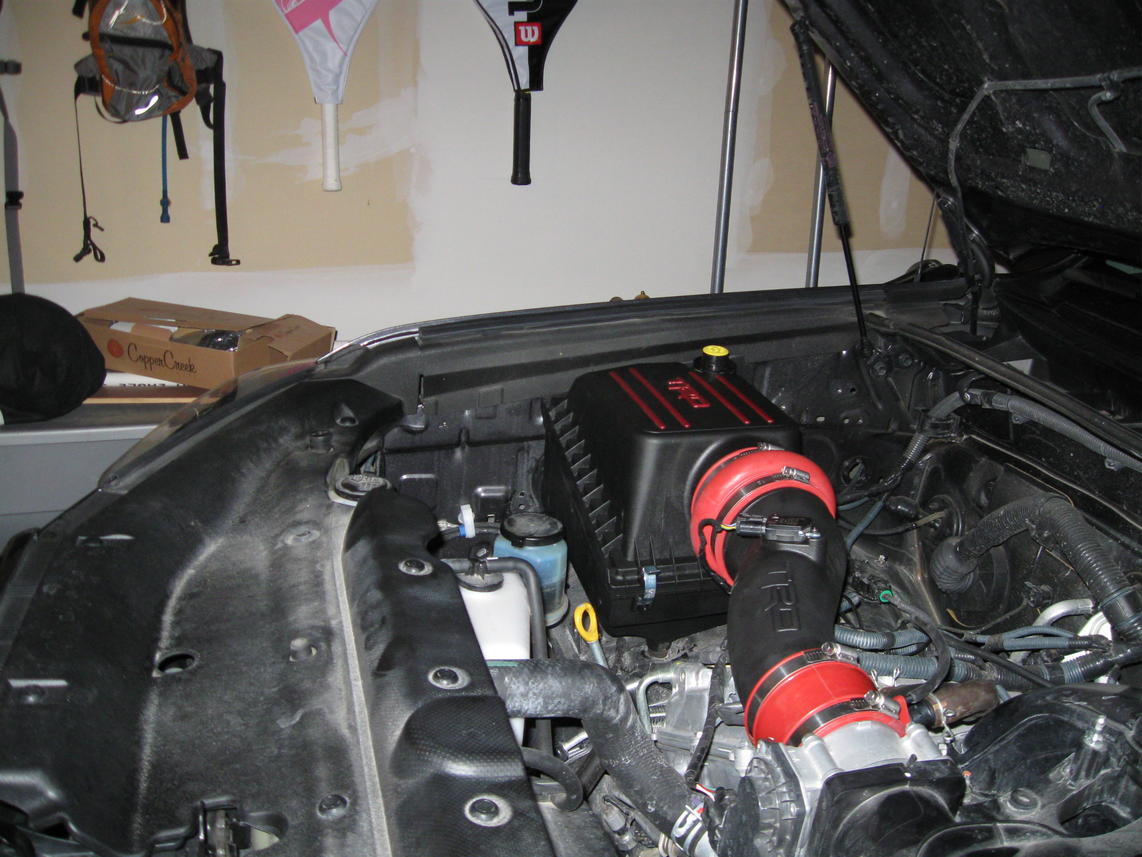

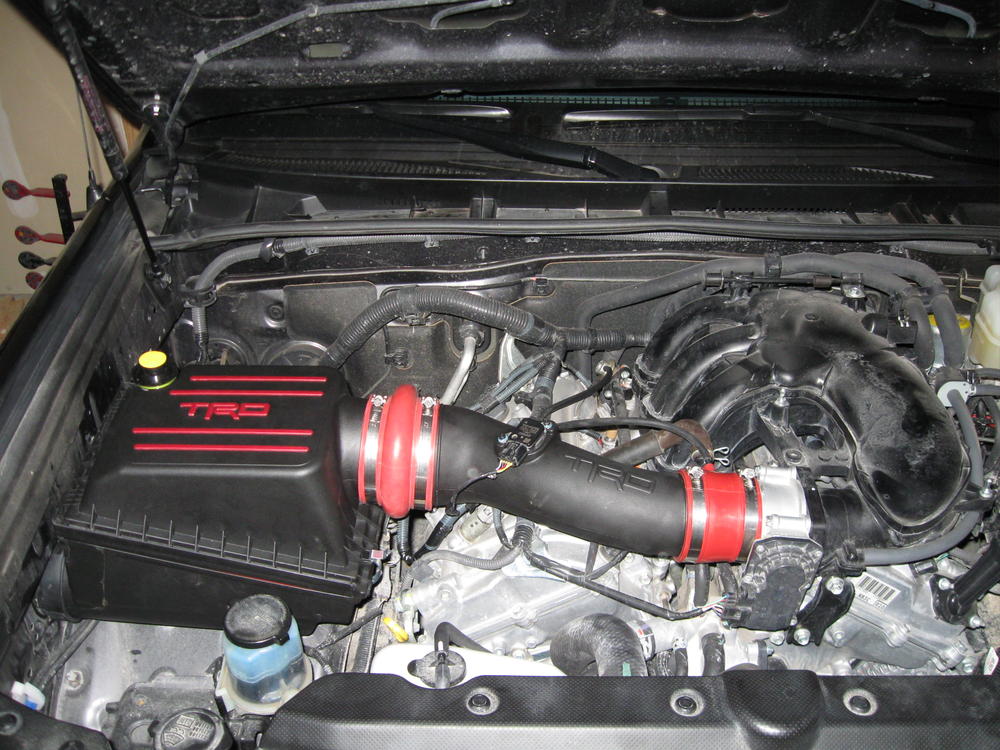

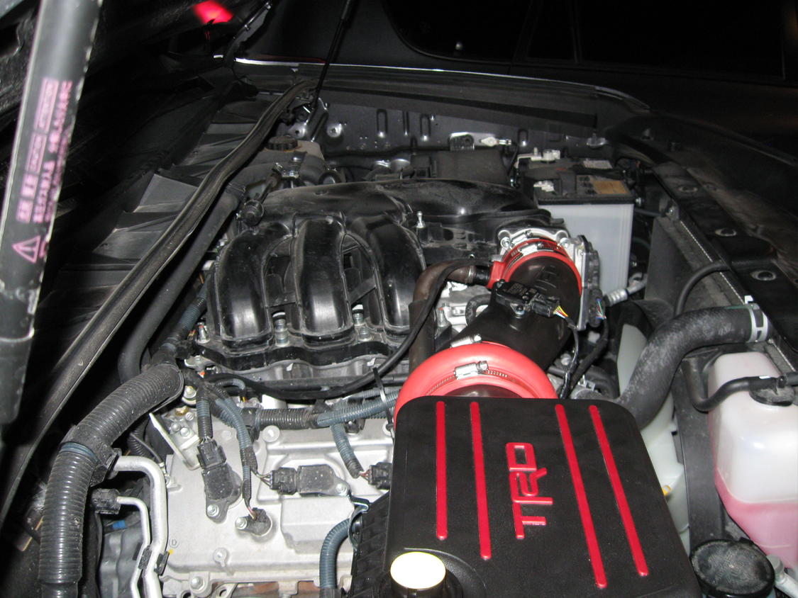

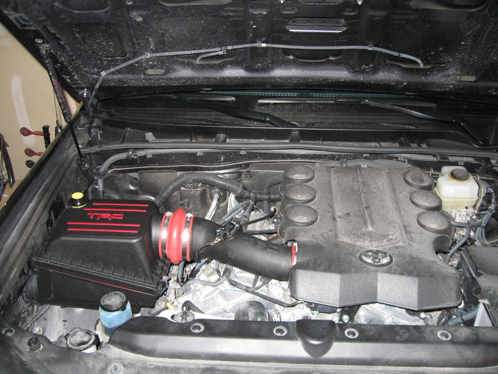

TRD Intake installed! The install took about an hour was pretty straight forward uses the same part# filter as the stock TRD drop in and as far as the whistle yes it has a whistle but I have to really listen for it over my mud tires and exhaust. The intake isn't any louder the stock here are some pics for your viewing pleasure!

Fitment is good the rubber is a real tight fit on the intake tube the instructions say use some silicone lube to make it slide in better I only had some PB penetrater so I used a small amount of that to help slide it in. The other thing that was kind of a pain was taking all the tape off from around the MAF to make it reach the new position of the MAF. But other then those few things fits pretty good performance is good it feels like it pulls alot harder at the top end of the rpm range. Gas mileage hasn't improved yet but I have been kinda hot rodding it today lol
