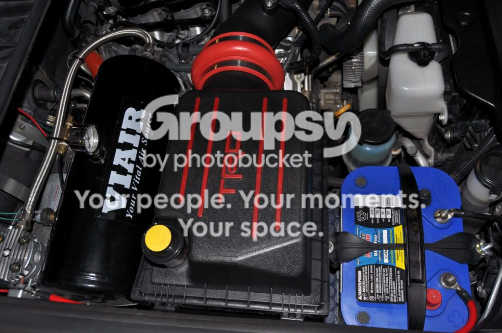

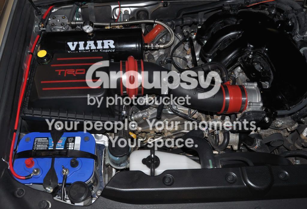

I finally had time to install my TRD CAI and the fit and install went smooth. The instructions on this are pretty accurate except I needed to add a washer to one of the bolts that hold the air box down to the fender.Took about 2 hours as I rewrapped the wires with electrical tape and put new split looms on them and wrapped again.
Just took her out for a little spin and it's definitely real loud when you get on it but seems most of the gains are in the high rpm range. Need more seat time to really tell but as I stated before it's mainly for looks . Unbiased dyno runs would be the only real way to tell.
It does look great and the fit was perfect.:thumb3:

For some reason not sure why I didn't need to add a washer to the airbox like some have it might be cause I had a K&N CAI on for awhile unless I wasn't paying much attention to it either it seems pretty stable though?
Just the two bolts for the lower air box did seem very stable, I added the extra washers from the hardware for the FJC installation.
