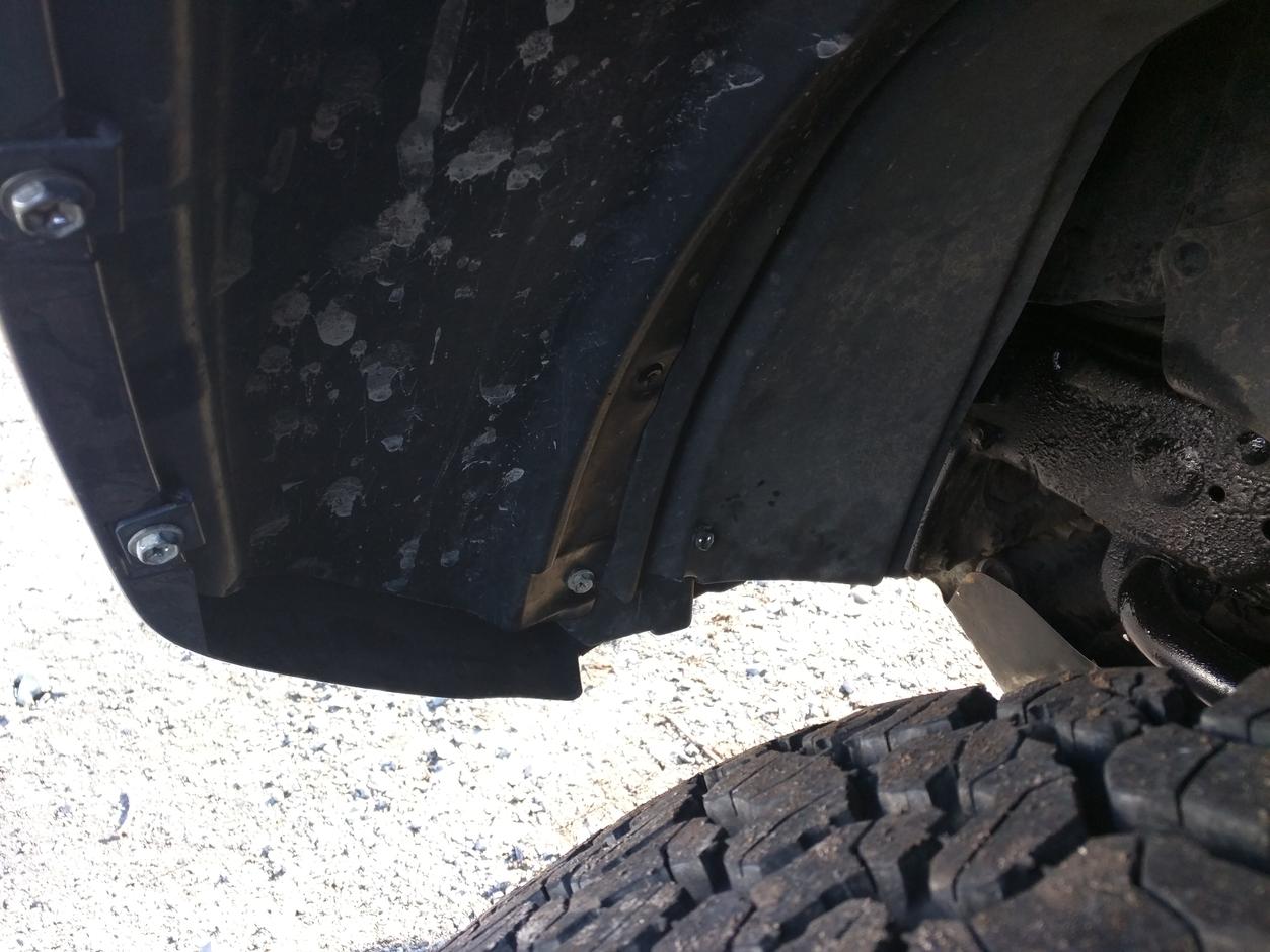

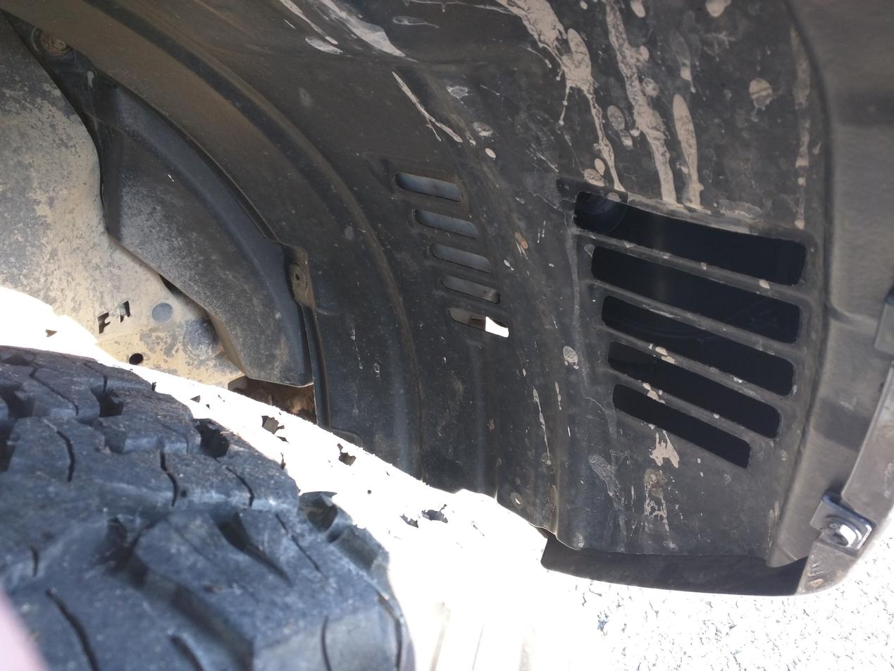

Hey, they are definitely different. Unfortunately, I don't the have the part numbers because I just modded the liner.
It was very simple to mod the liner. The back side of the liner where it protects the engine bay a little is where you have to get a little creative... Again not hard though.
For the liner, I simply installed the bumper and let the LE liner hang. It'll blow your mind how much lower it is! Then I just held it to the bumper and traced a line and cut along it with a razor. The holes on the wheel arch won't line up anymore but just slide the clips to the spot where they should be and screw it back together. The screw will go right through the plastic and hold it snug no problem.
For the back side, you'll have to cut the pieces shorter because they had to go much higher from the front LE lip. I tried to reuse as many factory points as I could but had to get a little creative.
Personally, I just forgot to get the liners and had a free weekend to do the bumper so I just did it. If you're looking to save a couple bucks, you can do it this way and no one will ever know.
