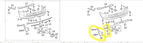

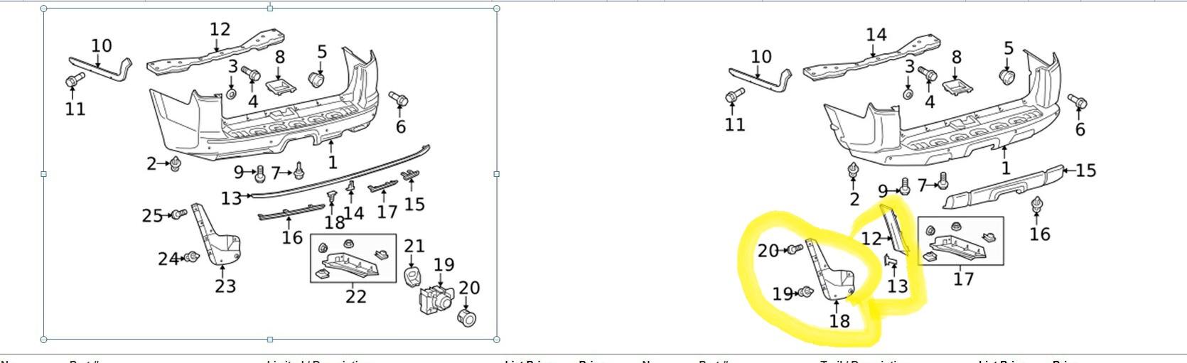

There are 2 pieces behind each rear wheel that I missed. Just a few more dollars at the dealer and cross our fingers hoping the parts will be in tomorrow.
Note these work on the limited rear cover but not on the trail rear cover. The part I need also doubles as the mud flap.
Nice looking truck. I'm actually in the same process of my 2011 T4R Limited. Just installed the rear bumper last week and noticed I had to order 2 brackets (located near each sides of the tow hitch) brackets: 52174-35090 (driver) 52173-35090 (passenger). They're about $15 each. Didn't see it on your post so thought I'd share.
Please continue to post your progress. I'm still collecting all the parts for the front end before tackling the job.
There are a couple more pieces that you will need to order. Here is a side-by-side compare of the rear covers. I highlighted them in yellow.

Awesome! I didn't realize your original post was a year old but Thank you! The rear bumper is installed and I'm now collecting the last few pieces for the front.

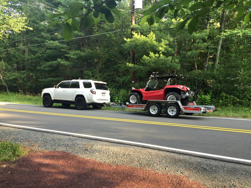

So serious question has anyone towed a car on a aluminum car trailer and if so tell me your thoughts.
The Trailers weigh's 1,200lbs and the Camaro weigh's in at 3,200lbs.
So we are pretty close.
Nice truck......I trailer a car....usually with an aluminum trailer. My car weighs in at around 1500 pounds. Tows easily for hundreds of miles. A set of airbags are on my wishlist as they will really help with the sag. 3000 pounds willl have your ass dragging.

Thank you very much.
I towed a friends Ski Boat and I didn't even realize it was there. I was planning on adding a top spacer on the front of my truck to get the nose up just a little more. With that being said I like the idea of the air bags. Looks like I will be calling Jo at Chi-Town and ordering up a set and installing them over Christmas break.
