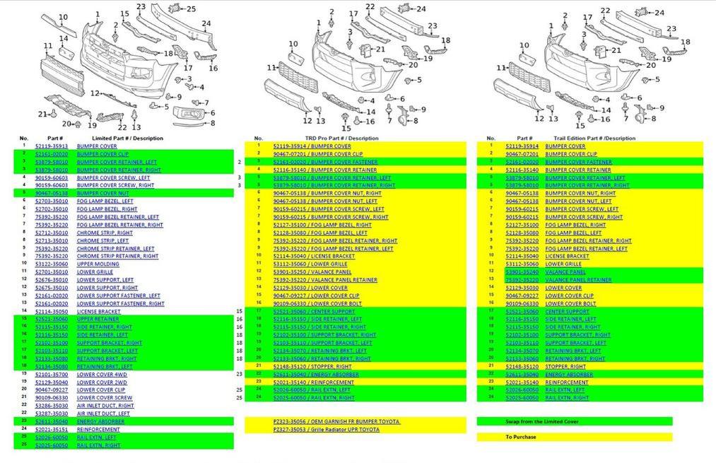

So this is what it takes parts wise to make the swap the front and rear bumpers from a Trail/TRD to a Limited. There are 4 more parts that I will add tonight when I get home. Which are behind the grille ducting air into the radiator.
I am still trying to figure out if there is a lower radiator close out panel that is used when you have the TRD Skid Plate. So far we have tried two of them and neither work.

Actually I really like the front end on my truck. I originally wanted the TRD Pro in Inferno Orange however I wanted a sunroof, keyless entry, push button start and the JBL sound system which were not offered in the TRD. So the plan from the get go was to basically just do a TRD swap on my truck. I am still not sure if I am going to do the rear bumper as I really like the rear.
Still not sure if I am going to paint the lower TRD facia on the front cover silver or leave it a matte black.
I was torn between the TRD Pro and the Limited for the same reasons (plus the Limited had the rear a/c ducting and vented front seats).
I immediately thought I could just swap the front end but realized it was much more involved.

Originally, I thought it was a big deal to do the swap and honestly it was not that big of a deal. Just order the parts have them painted and you can honestly
swap the parts in your garage basic metric tools.
