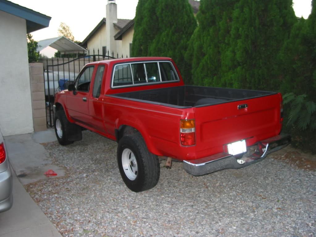

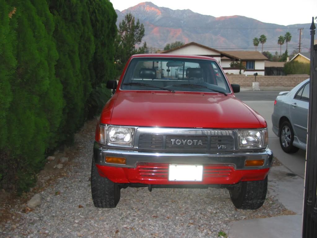

So last week while cleaning the attic I found pictures of my second Toyota back in the day.
Thats awesome! Its the same truck as mine, I cant bring myself to get rid of mine even though it doesn't exactly fit my family anymore. Do you miss yours?
I am trying to remember what year it was and heck ya I miss it.

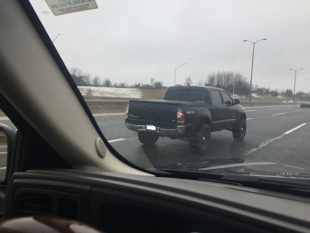

I saw this one the other day and I told myself I am sure I can convince my wife this would be a good car for our Daughters to Drive back and forth to school and for here to drive when the weather is bad.

Your old Toyota looks awesome. My uncle had an older 80's Toyota Pickup when I was a kid. Single cab lifted with big tires. I thought it was the baddest it truck ever.
It has to be an 89 or 90 with that grill. Mine is a 90. Crazy to look back at mine from when I bought it, you know what it looks like now.

That is awesome and I need to keep looking for more pictures.
Somewhere there are picture of my first truck which was an 84. Somehow it ended up on 44" Ground Hawg's as it spent a good portion of it's life doing Mud drags at Union Grove Drag strip in Wisconsin. We even towed it home with a tow strap when I blew up the camshaft.
