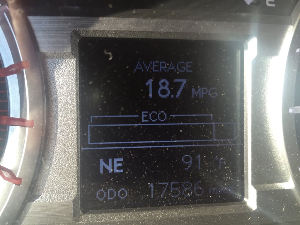

So I did my average mpg cruising at 77 for a majority of the ride. I was pretty happy.

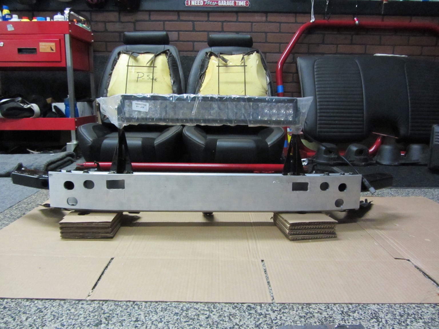

I picked up a front cover from a fellow member and I stripped all the parts off that I needed.

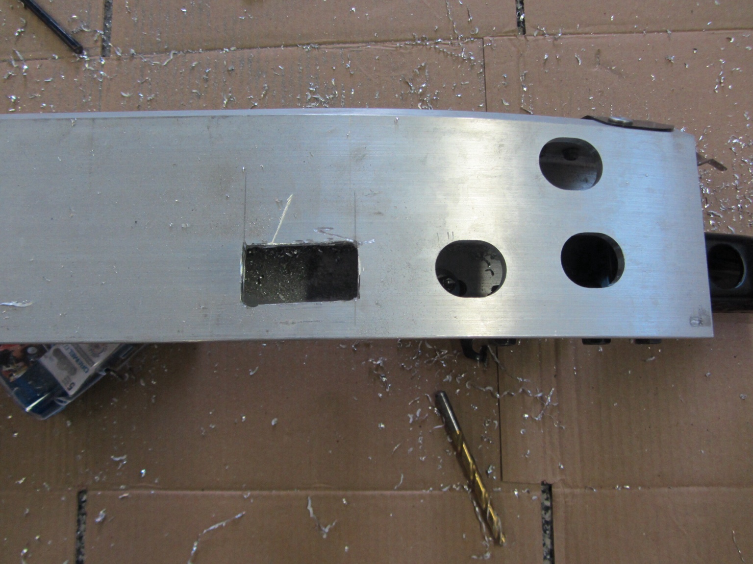

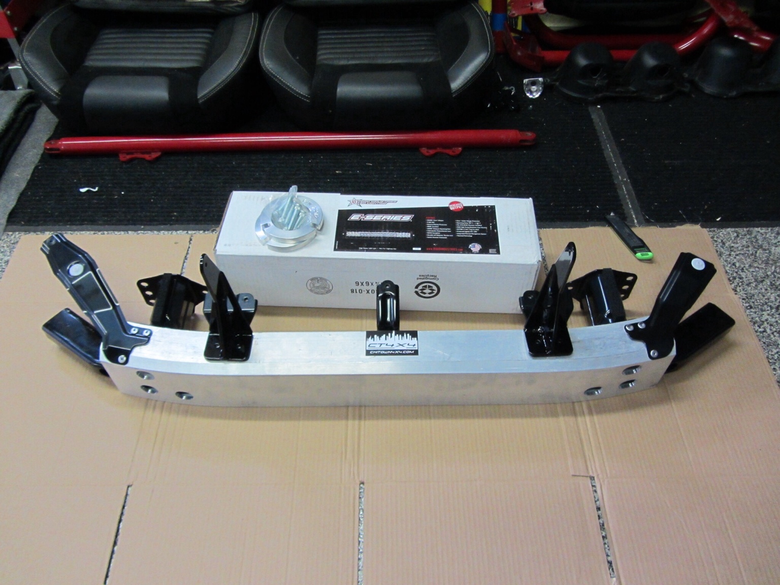

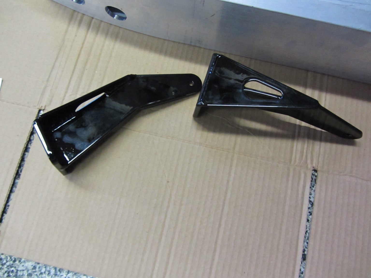

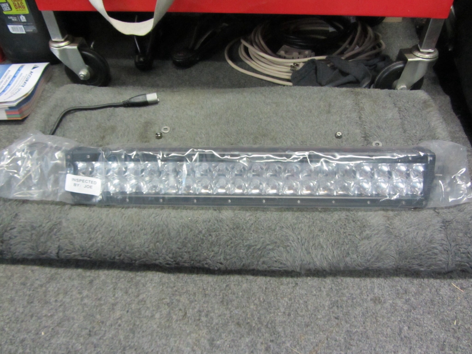

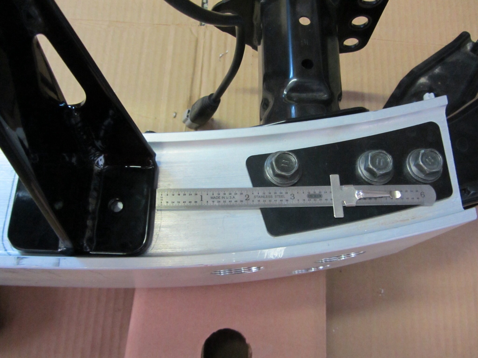

Then it was time to install the behind the grille brackets I received from Brad. I ordered a 20" Rigid light from the guys at Chi-Town 4x4. Super easy to work with and plan to spend more with them.
Centering the light was fairly easy using this method.

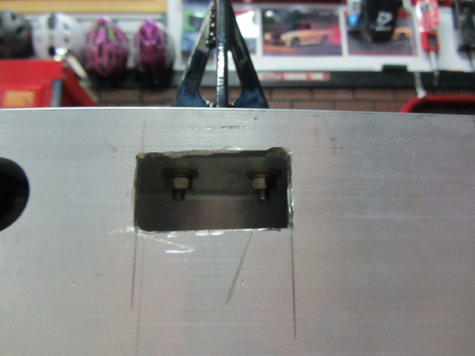

Since I tend to lean on overkill so I added a nut to the bottom of the light brackets instead of just tapping the bumper.

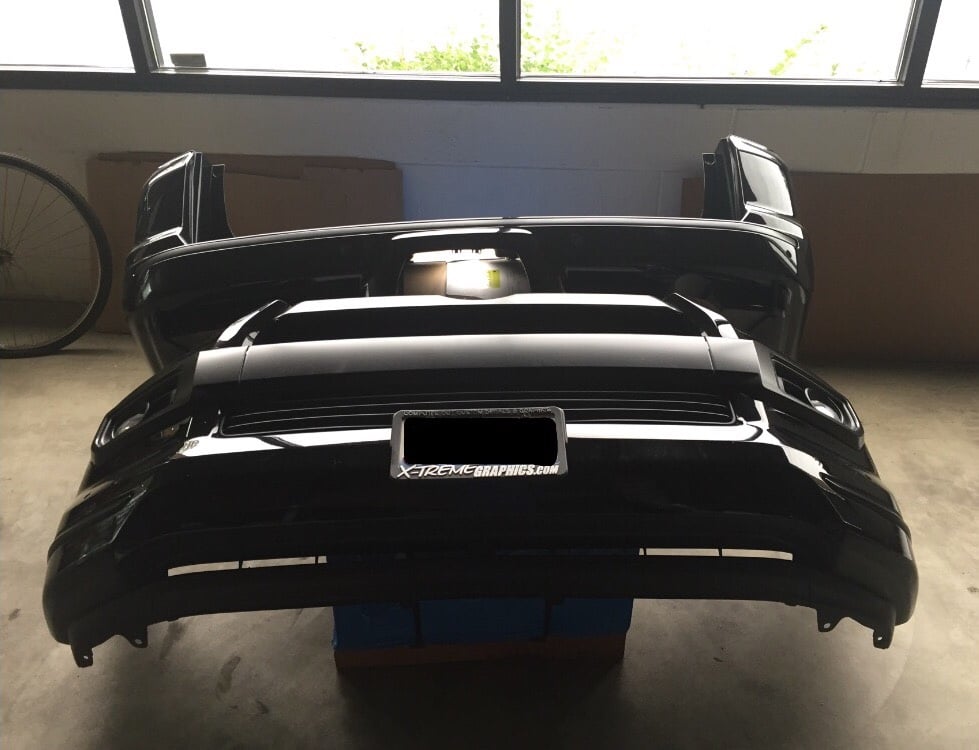

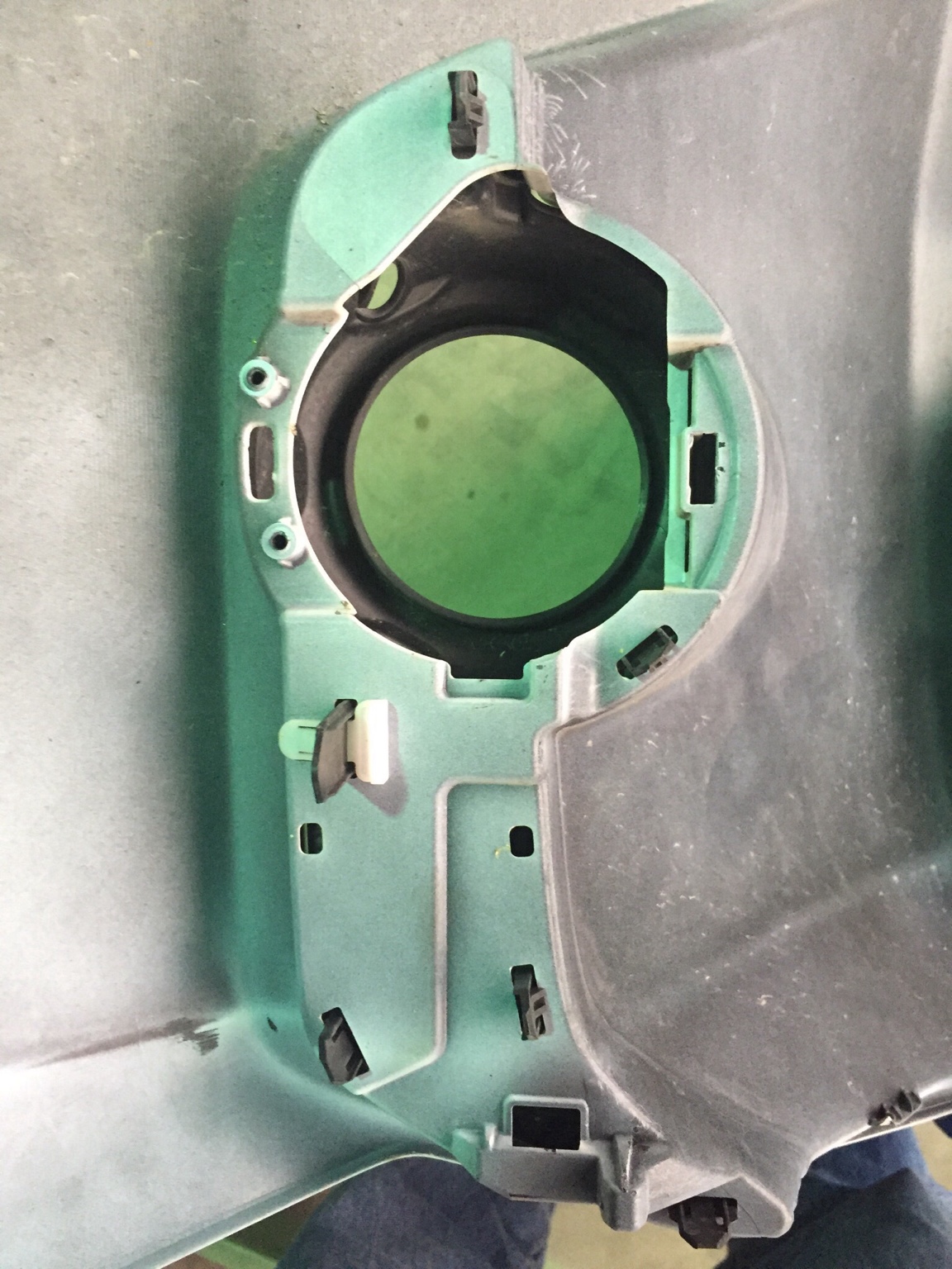

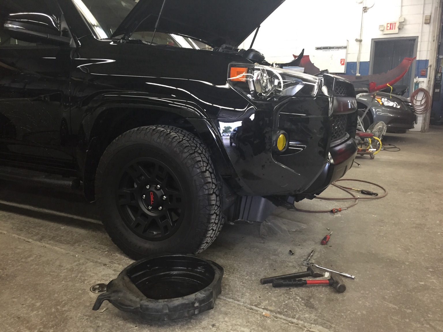

The guys pre-painted the bumper before I dropped the truck off and they mocked up all of the parts on the stand to see if I still wanted to do the swap.
i.php
Lets not tell my wife what this little part cost.

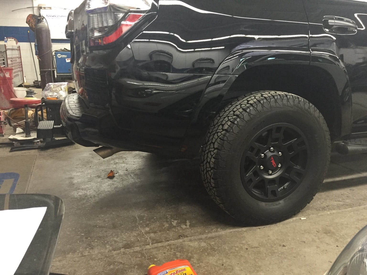

Moving to the rear bumper Ron had to modify it a little for the rear sensors.
He did a nice job tucking in everything nice and tight.
Sorry for the crappy cell phone pics but I wanted to have a few on my phone.

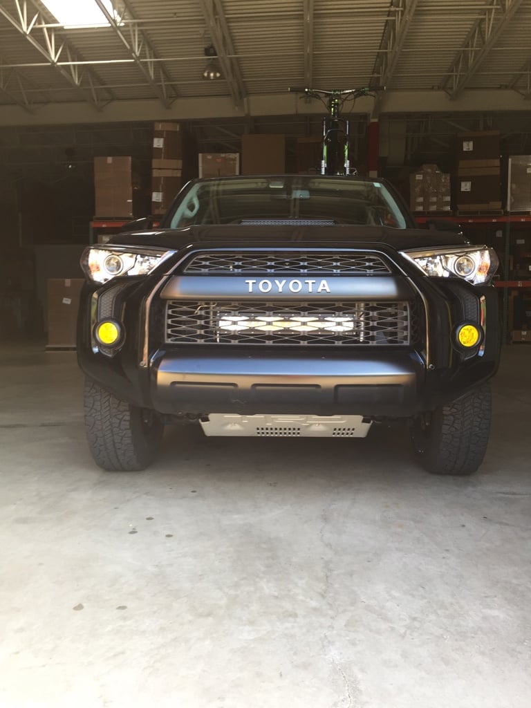

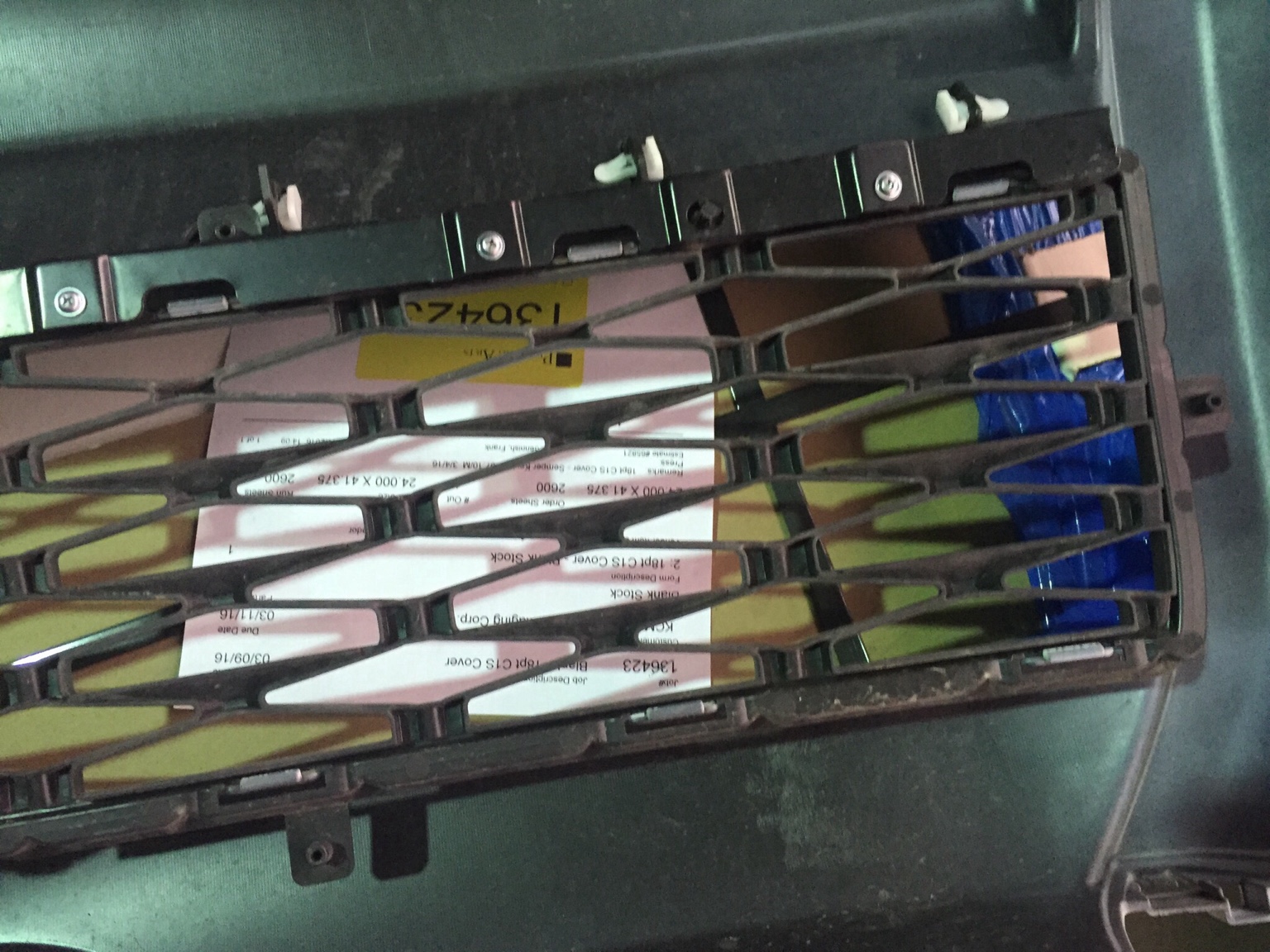

When we mounted up the front cover we noticed that the light was touching the grille so off with the front cover so we can move it back just a little.
Ron re-drilled the brackets and moved them back about a 1/4"
Not done yet still missing a few pieces.

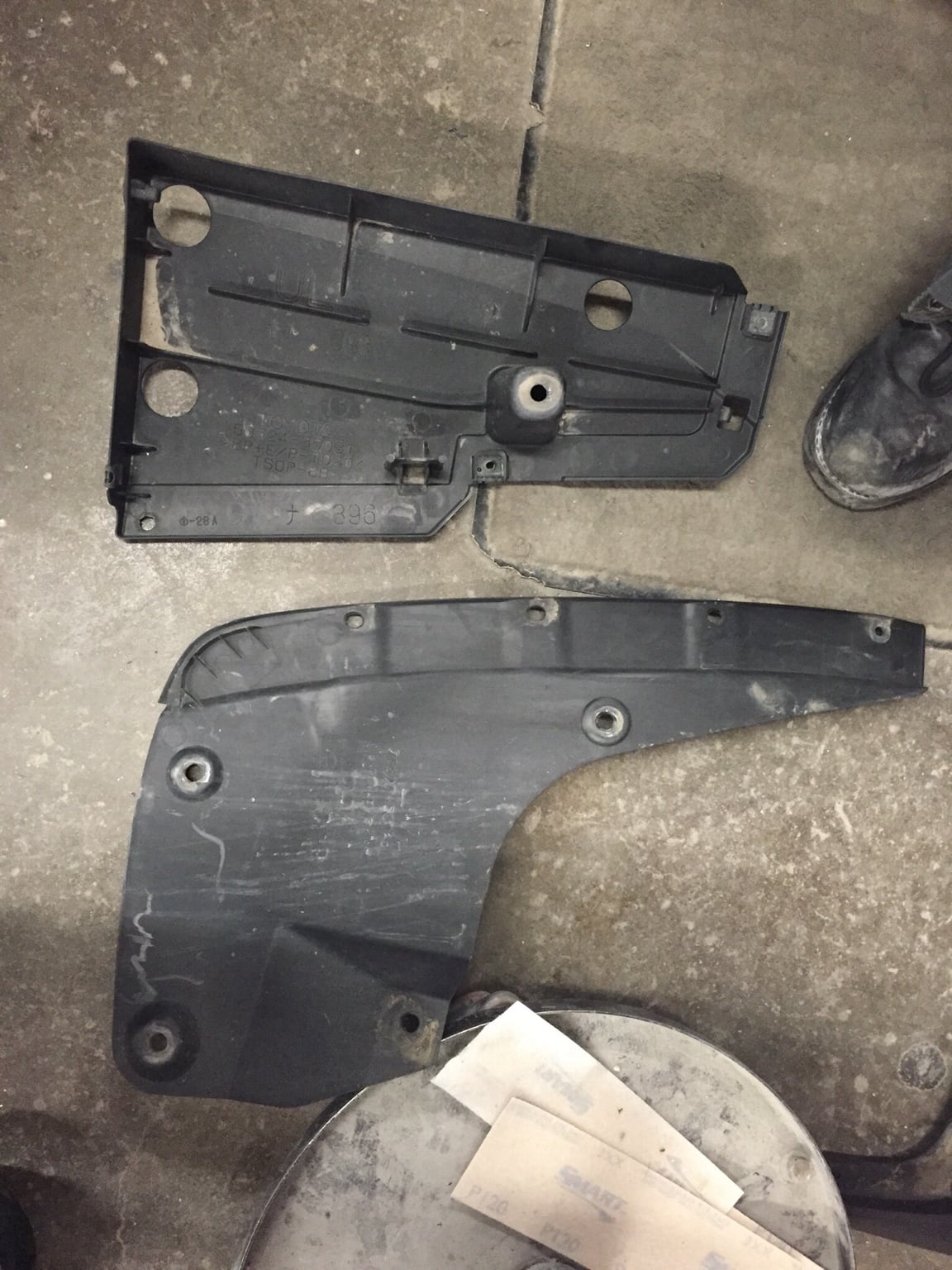

There are 2 pieces behind each rear wheel that I missed. Just a few more dollars at the dealer and cross our fingers hoping the parts will be in tomorrow.
Note these work on the limited rear cover but not on the trail rear cover. The part I need also doubles as the mud flap.

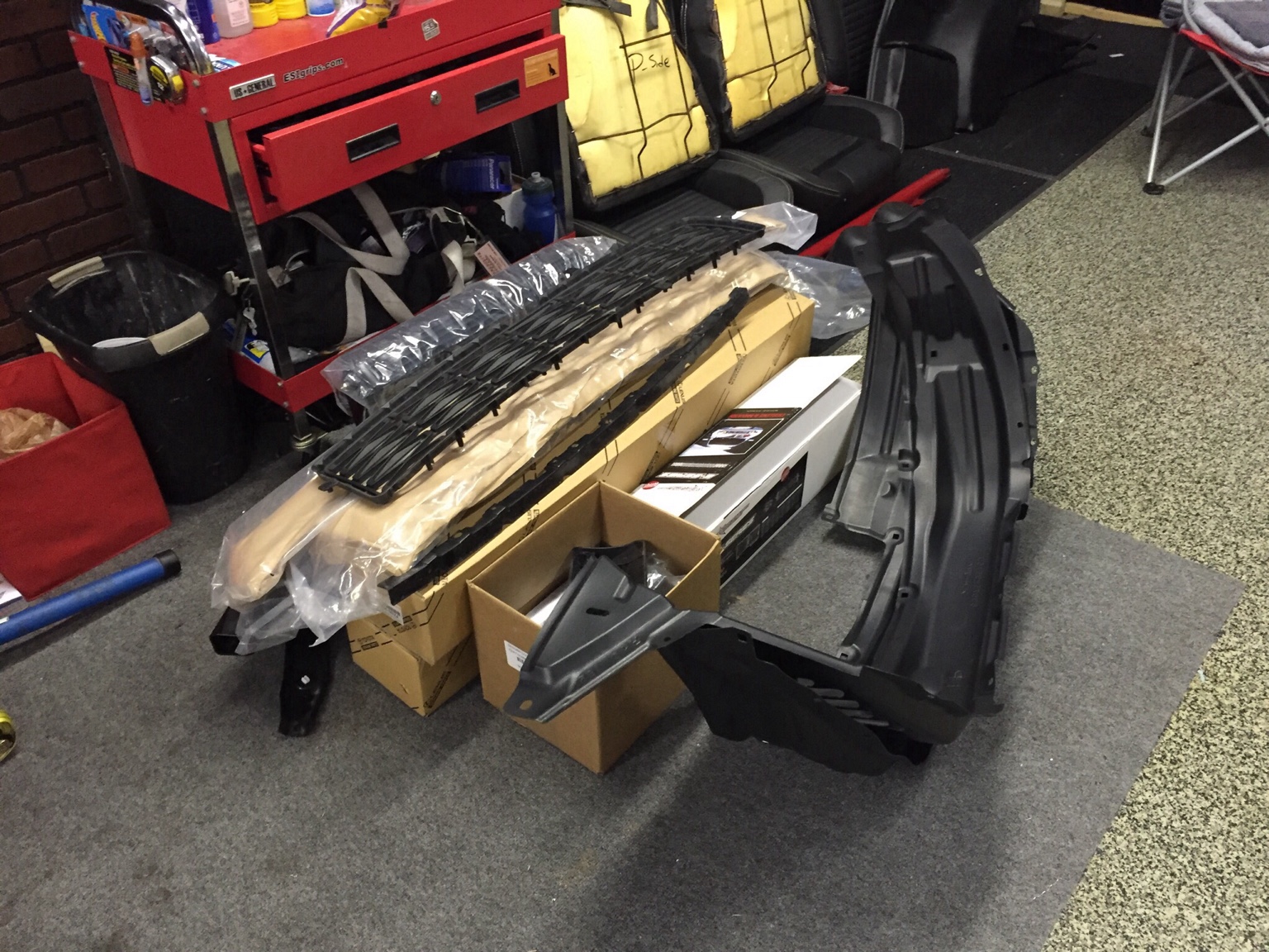

Front bumper and all the left over parts are all packed up and heading to a new home on Monday.
Btw David when you get the crate please don't comment on how bad it looks.
Oh and have fun with all the bubble wrap.
That's some legit packing, shipping must be a premium.
Whoever is getting that bumping is in for a treat, best stock looking limited bumper out there.
Btw David when you get the crate please don't comment on who bad the crate looks.

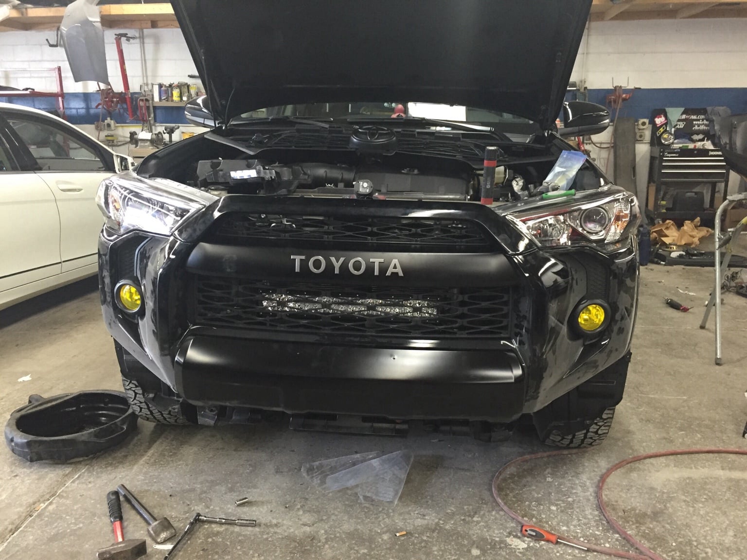

Finally.
Since I took the hood swap picture here I figured I would repeat the front end swap picture in the same place.
