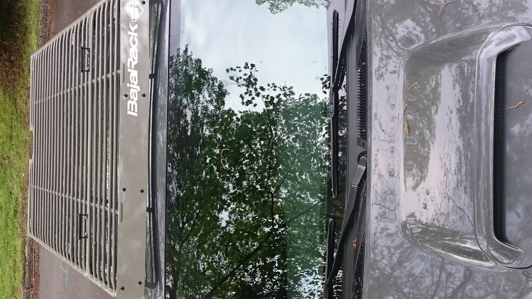

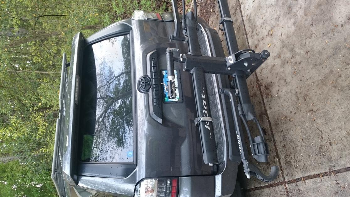

Started with a Kuat NV and a Baja Rack that I got for only $400 thanks to a tip from another forum member. Cut the basket top off the rack, lowered the fairing, and welded a piece of flat bar across the top with 4 holes punched in it. Powder coated the rack, and mounted 2 Kuat fork mounts along the flat bar where I punched the holes. This way I can carry 4 bikes easily, or 2 bikes & 2 kayaks.
I didn't like the idea of the hitch rack extender (for many reasons). I do wish that I thought of a better rear wheel option like yours before I had it powder coated. My solution for now is individual straps run through the bars on the rack. I feel like I could fit a third (backwards) very easily. BTW, I got the same light bar mounts from Brad as well. They are great.

Wow that is a great looking rack.
I am trying not to extend mine all the way to the front but after seeing yours I am seriously considering the thought that I had in my head. I love the look of the completely flat rack and the functionality has to be awesome.

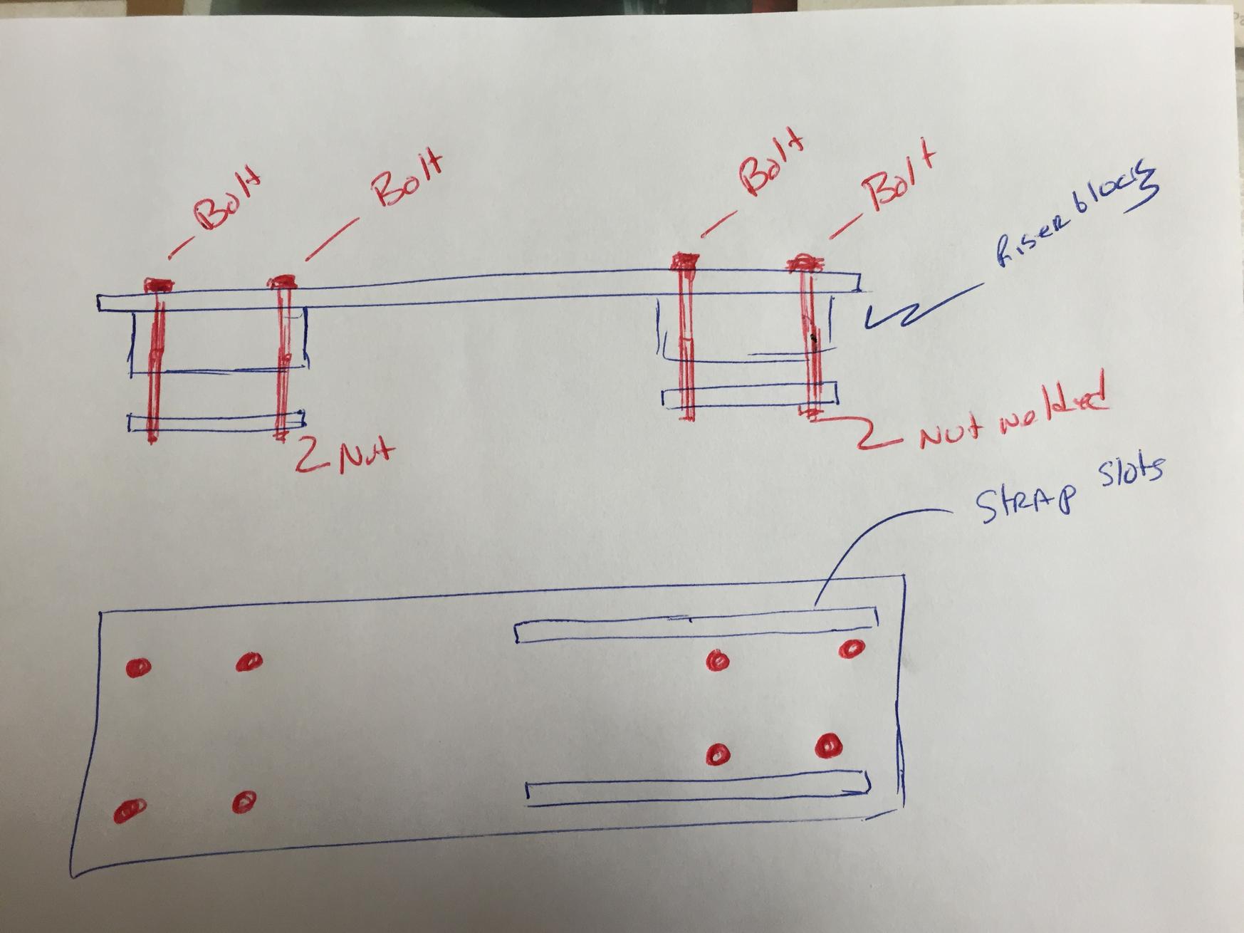

As for the rear wheel mounts for your. I don't think it would be that hard to duplicate the idea using a flat 4" x 16" plate and then use 1/2" x 3" metal straps to secure it down.
Okay attached is a very crude sketch of the idea in my head.

As for the rear wheel mounts for your. I don't think it would be that are to duplicate the idea using a flat 4" x 16" plate and then use 1/2" x 3" metal straps to secure it down.
Thanks! Your sketch has my wheels turning again now. May be time to hit the shop again next week :)

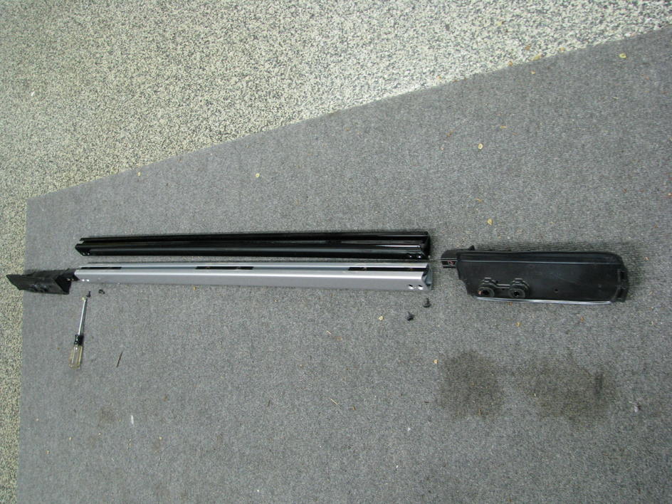

I finally swapped the roof rails this weekend with an extra set that I purchased off a member here on the board. I will be dropping my silver set off at the powder coater this afternoon and having them powder'd black.
So when the next local guy is ready for the swap I have a set sitting in my garage. Right now I have two guys on the list.
