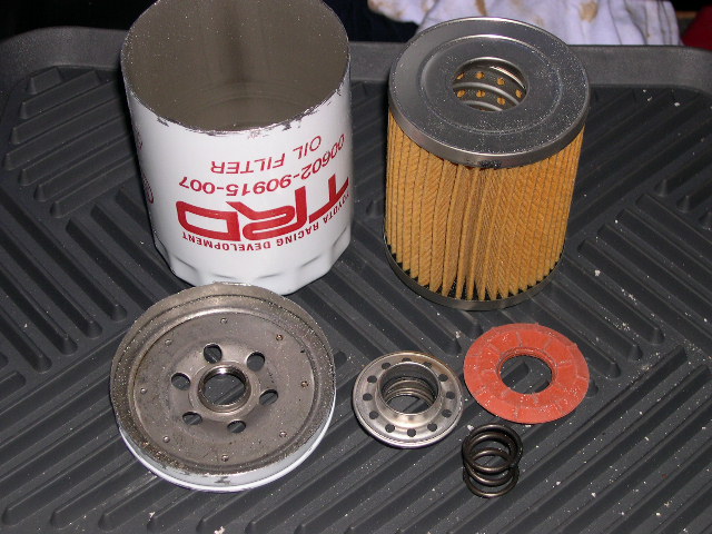

Here you go! I dont know what a good filter look like but this TRD filter look like a filter with end a filter? Enjoy!

Thanks for doing that, man. That will really help us know what we're comparing here.
I'm not saying there's anything wrong with the TRD, but honestly I'm more impressed by the OEM filter. The synthetic organic filtering media is some really cool stuff that you don't even get from such quality filters as Mobil 1 or apparently the TRD.
After looking at that filter I would have to figure this
-If you drive hard (thus having a use for the extra flow capacity) or would like to extend your oil change intervals, I could see an advantage with the TRD.
-But if you just want to maintain the upmost protection of your engine, without having a need to depend on any extra oil flow (outside of manufacturer specs such as would be required with a supercharger, etc), the OEM filter is my choice.

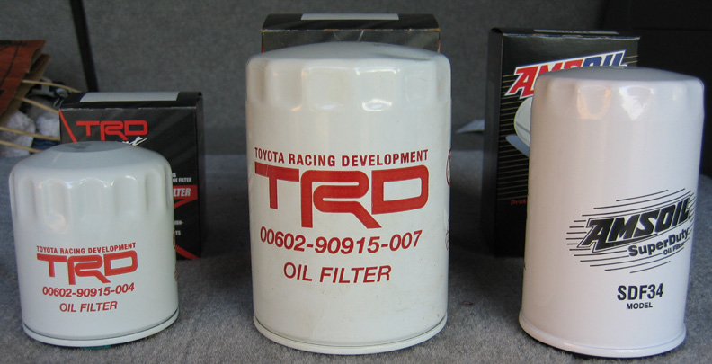

Since I can't fit the big TRD oil filters on my V8, I have found a good Amsoil alternative. I just bought the SDF-34 filter. They are the same width as the original filter, but nearly twice as long. So, I am getting the additional filter area, in a different shape.
Here is a photo of the big TRD filter, another TRD filter that is the same size as stock, and the Amsoil filter.

I just read that the Amsoil filter has a anti-drainback valve like the Toyota filters, but do you know how much pressure the Amsoil filters are rated for?
I know the Toyota filters are rated at 60 lbs, and a lot of competitors are rated at 40 lbs.. Or at least thats what the guy at the dealer said, that the Toyotas need 60 lbs of oil pressure and have had some cars roll in to service because the aftermarket filter blew.
