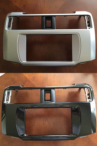

Body-shop painted:

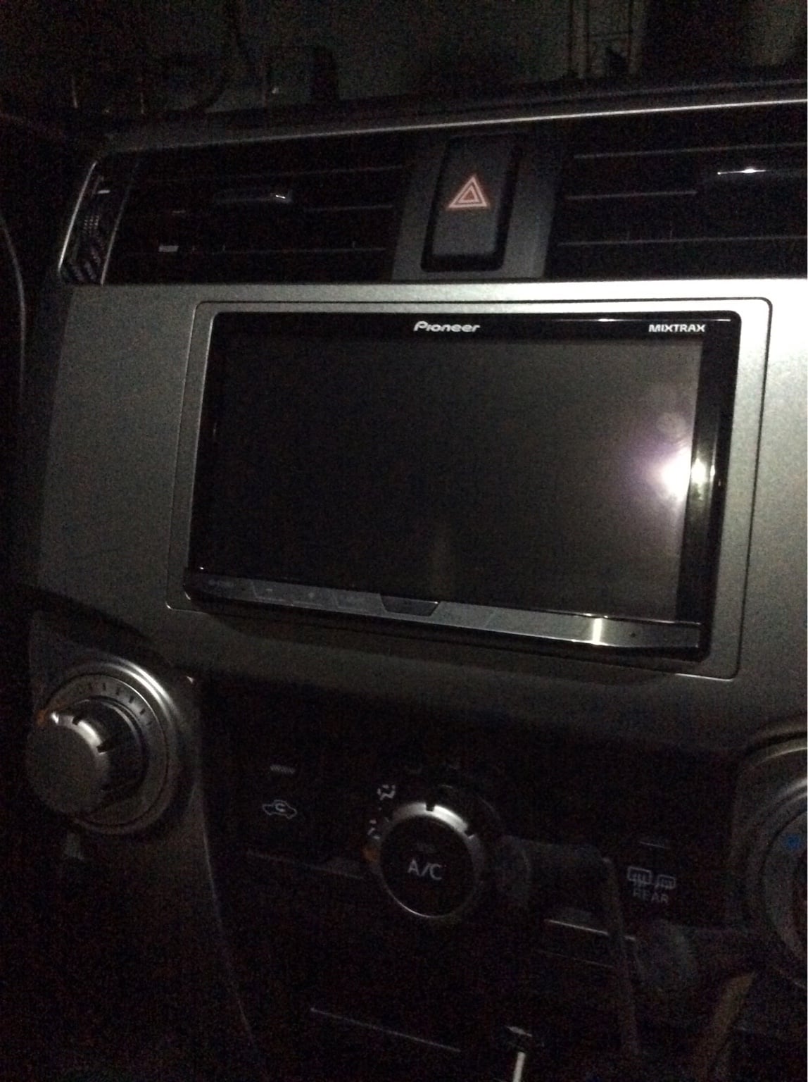

Taken with the Pioneer:

Finally! I dug this up Googling for any results of using the Rustoleum metallic black paint on the Scosche kit. That looks amazing! Did the shop pull off the same super smooth high gloss finish as the OEM trim? It looks like it in the pictures but I can't tell if it's as deep and slick.
Yes, the result from the bodyshop was 100% match with the rest of the factory interior. When I dropped off the kit, I actually left one of the side pillars with them so they could be certain it would match.

Here's a close-up showing the painted kit (top) vs the factory paint (pillar/bottom)
I ran a USB cable from behind the head-unit, under and inside of the center console to connect to a mounted ipod

Did anybody ever find a non-shop solution? I went opposite direction. I bought a trail/trd radio for a decent price and am trying to paint the trim to match.
I tried rustoleum black night metallic. And it's not really close. At all. With that being said, it's not too different to where it bothers me enough to buy the right trim pieces or get a quote from a collision shop. Just seeing if anybody found a good, cheap solution.
