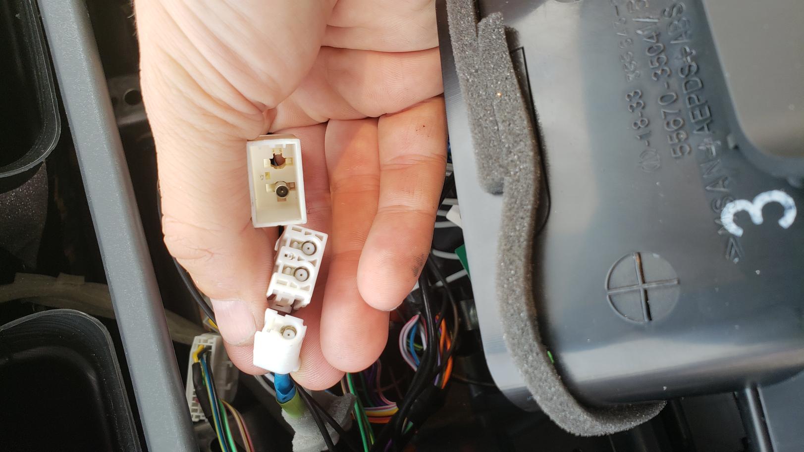

I also recently swapped out my deck, and went with the pioneer 8200nex. Problem is, I have terrible reception! I used the Metra 40-Lx11 antenna adapter. When installing it, I noticed the antenna wire from the truck had two prongs in its connector while the Metra only had one. I verified also that the blue wire was connected to the stereos antenna wire. Anyone else have a problem with poor FM and AM reception?Has anyone figured out what the second prong is for on the plug? Thanks in advance !
1) What year 4Runner?
2) The single plug in the bottom is either the OEM GPS or SiriusXM antenna depending on if it goes up into the dash (GPS) or down to the floorboard (XM). So you should be working with the double connector which appears to be keyed that will only fit one way.
3) Did you solder connections, use crimp butt connectors, or use the fancy offset clip fittings?
4)3) The Metra Adapter blue wire should be connected to your radio's power antenna wire (typically Blue/White). The 4Runner uses an amplified radio antenna. Without the power it's going to have nearly no signal, and poor reception. With a multi-meter you should be able to ensure you've got DC12v on the Metra adapter blue wire without having to tear the harnesses apart.
Yeah, I went back and made sure of it. I have heard that older 4runners have two antennas, one for AM and one for FM. Not sure if this is what the second antenna prong is for in the connector..... the reception is terrible.
The truck has a diversity antenna, meaning a secondary back up antenna. The after market radio does not have a diversity antenna tuner so that is why the adapter only utilizes the main antenna.

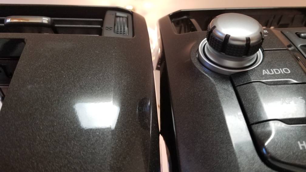

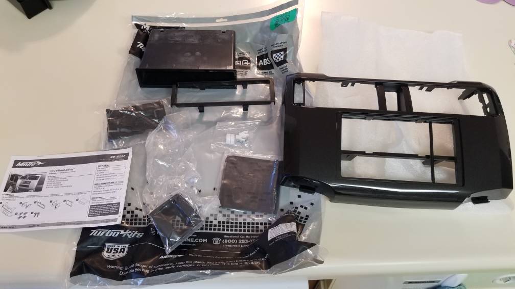

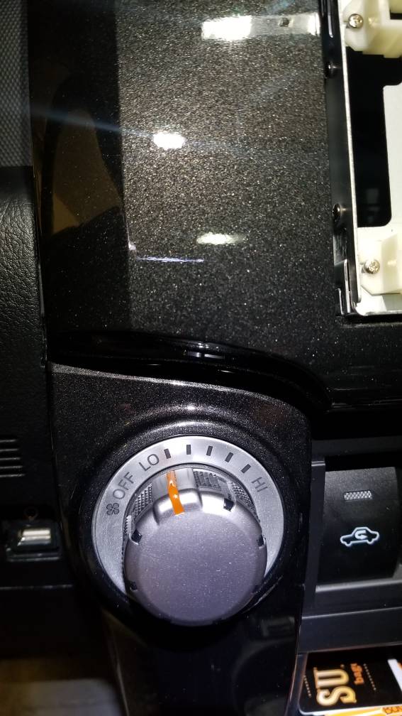

It doesn't seat perfectly at the top, but that may be due to my stereo sitting a bit lower. Overall, it's exactly what I had expected. Color is about 92% accurate, and the fit is about 93% correct. I'm happy with it. Here's some pics:
