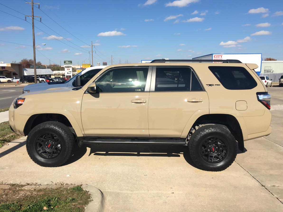

Just picked her up from having the lift put in

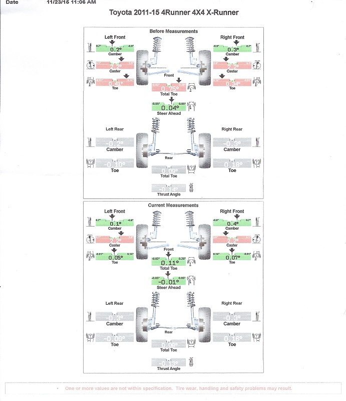

Hey everybody,
I also installed the Toytec lift kit for the TRDP but wasn't as fortunate as [MENTION=123355]WakeDreams[/MENTION] with having somebody to help. I did manage though to install the whole kit without any spring compressor by following [MENTION=48991]sp8ball[/MENTION] 's Mod Thread: http://www.toyota-4runner.org/5th-g...%92s-ideas-since-mid-2010-a-6.html#post754964. You will need a couple very long prybars though to make it easier on yourself but it is definitely possible.
I went and got an alignment done yesterday and these were the results:
(top before, bottom after)
http://www.toyota-4runner.org/attachment.php?attachmentid=181195&stc=1&d=1448417493
As you can see the caster is still off but not by very much. The official min is 2.6 deg and mine still shows 2.2 deg. I'm convinced though that the toe is more important for the wear on the tires.
