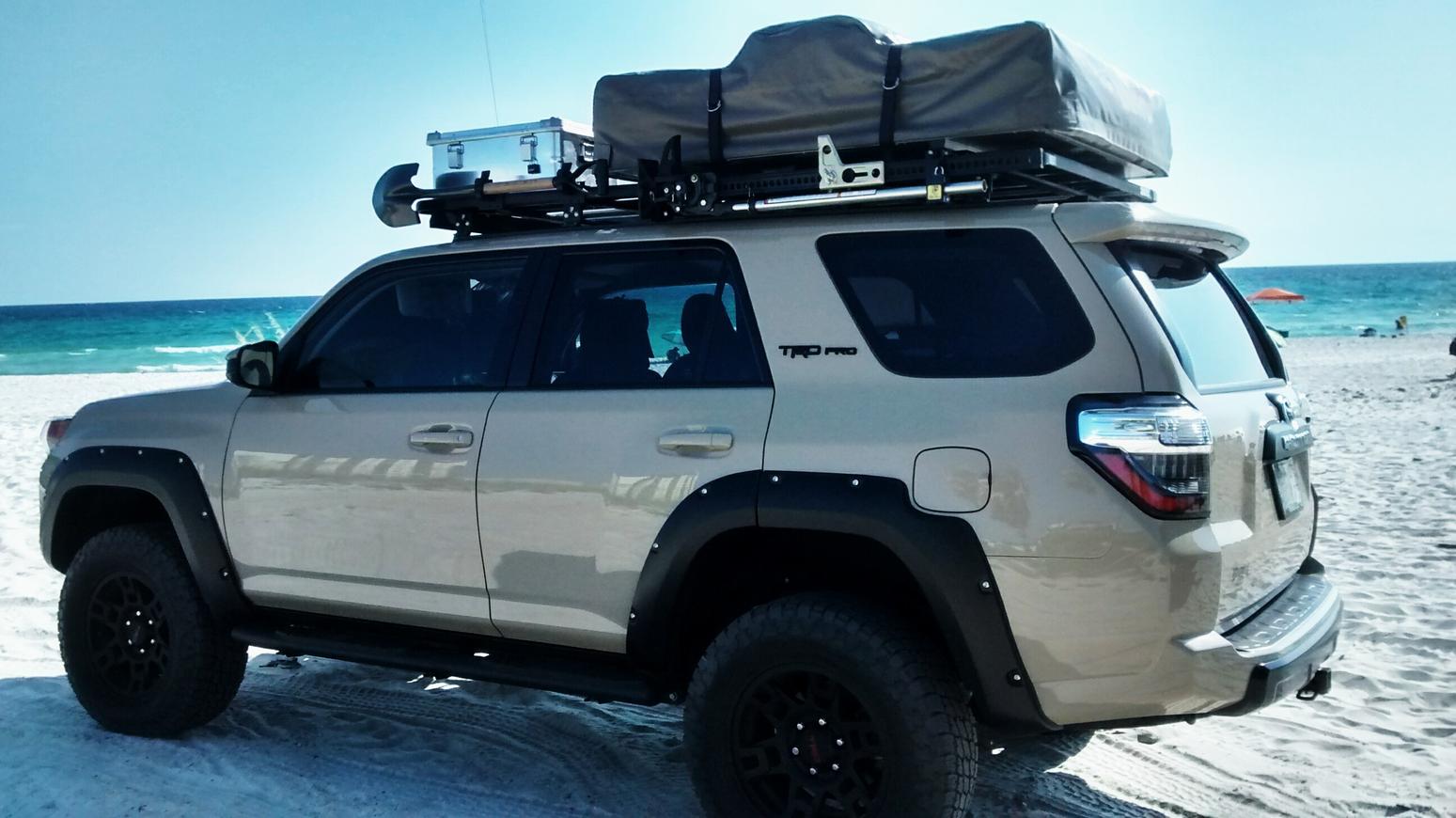

Pic

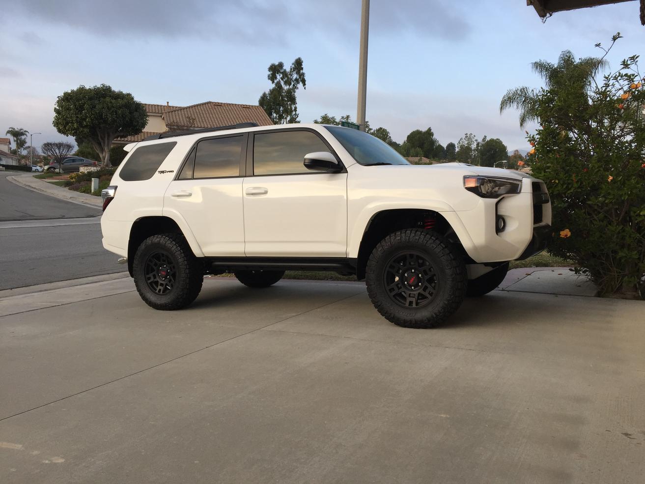

That rake absolutely drives me nuts with the toytec kit and its the only reason why I've been so hesitant on buying the kit. I did a 1 inch spacer from cornfed up front to match the factory rake (still a slight rake) but I've been talking to Dave at cornfed and he says he can make any custom size spacer to accommodate any type of rake. Im looking to order the SAW rear springs, installing them and then taking measurements so that Dave can make me the right size front spacers. All in all, it'll be about the same price as the toytec kit.
IMG_3661.jpg~original
