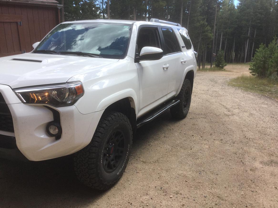

Just as a FYI, I have the BFG KO 2's in the 34x10.5x17 flavor for over 30,000 miles without any rubbing issues.... this is with the Toytec lift, Toyota TSB suspension performed, Stock TRDP wheels, no spacers.
Also, no suspension clunk since the TSB was performed with multiple single digit mornings this past week.
Please note, the Nitto or Toyo 285x75x17 will be larger than the 34" BFG setup I have and most likely rub with this configuration......

Thats amazing that you do not rub at all. Today I had a set of 255/80/17 cooper st maxx's installed and it almost rubs in the front.

Its not amazing, its just knowing how BFG's run on the small side, and banking on thier past history of sounding awesome in size and always coming up short. Sounds like I'm reliving my youth all over again... :boink:
..... I would bet you a fine Colorado beer, that your Coop's, in metric 255's (33's), are almost identical to my 34's in ACTUAL height and width....
Tire mfg's have a general lee-way (spelling?) with their measurements, and all of our trucks have a little tolerance stacking that makes this a very controversial subject.... So, rock the Tall and Anorexics (skinnys), and let them rule the day. Its the widths of the tires that usually kills the plan and introduces a body chop and other surgeries to fit our new super cool shoes....

Love the white with black rims

Thanks for the info. The differing reports of "no rubbing", "rubbing" running 285's with the Toytec TRD Pro lift makes me think rubbing most likely would occur in certain situations. After doing more research I'd probably opt for the 34x10.5x17's as you get just about a full 2 inches more in diameter over the stock 265's. Fills out the wheel well more. I like the look of yours.
