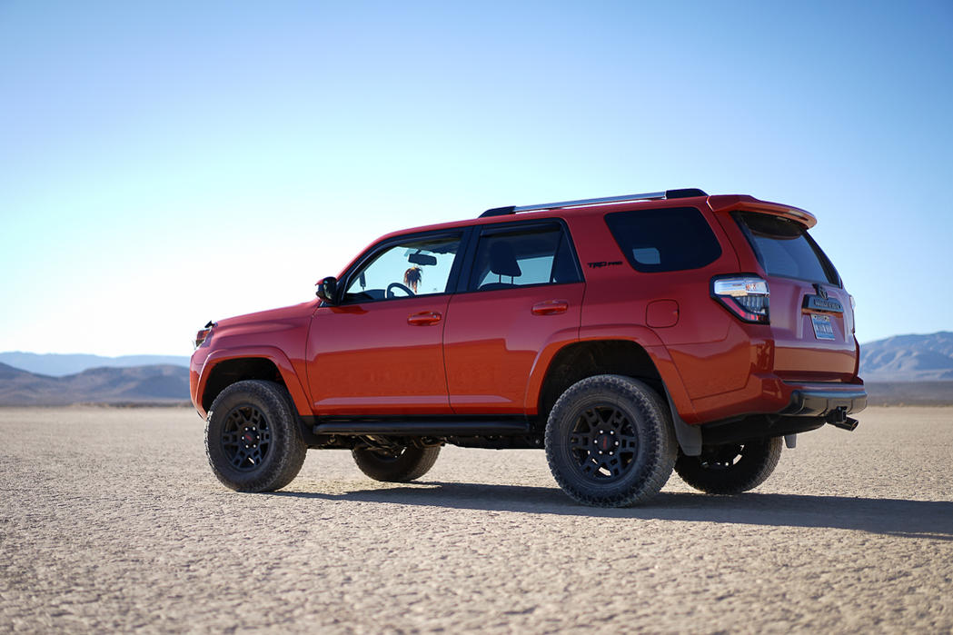

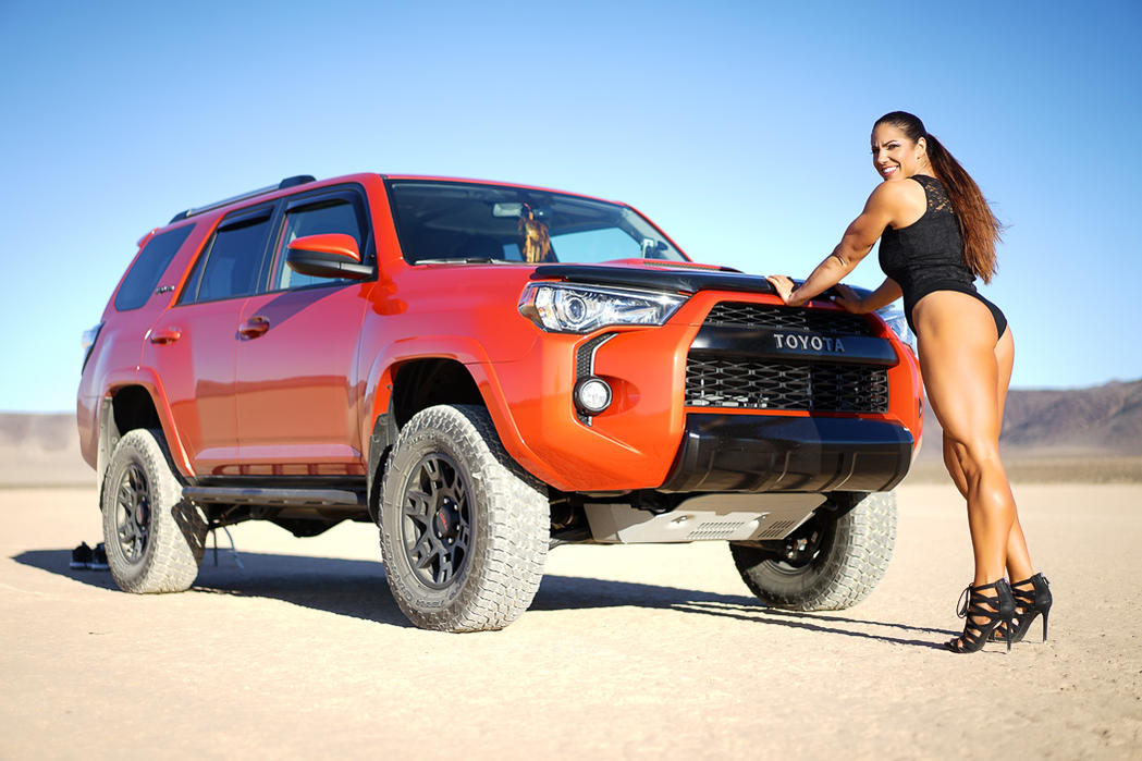

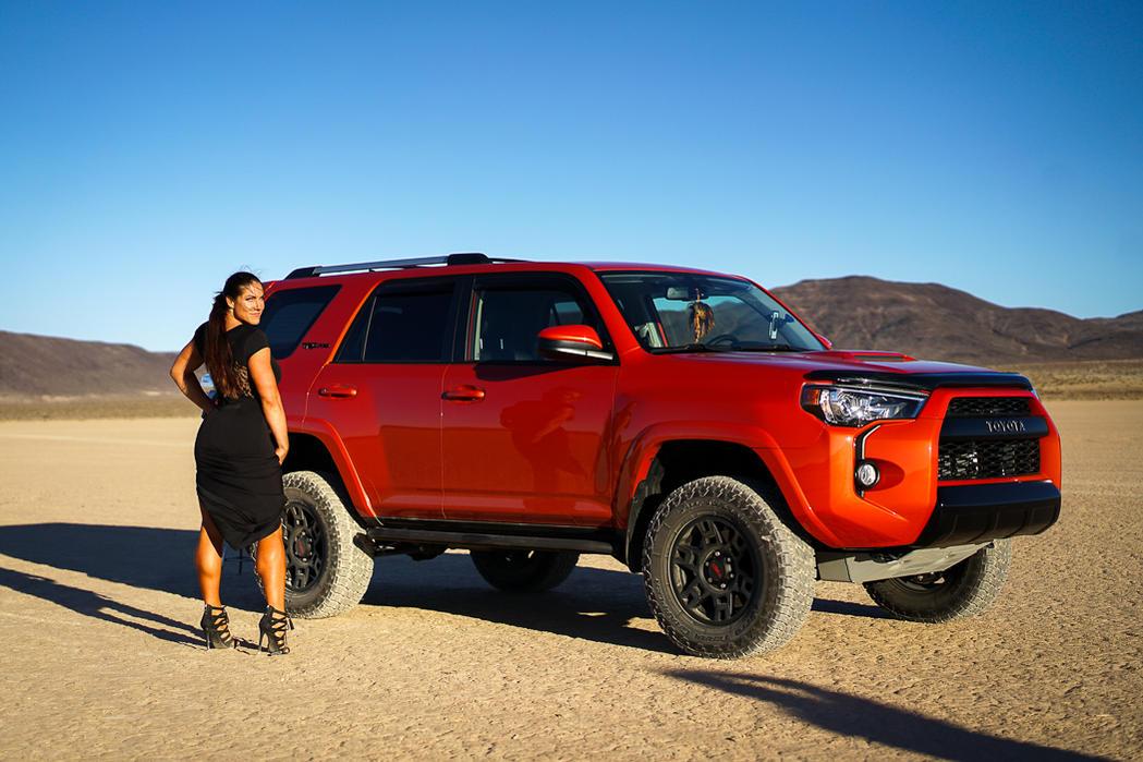

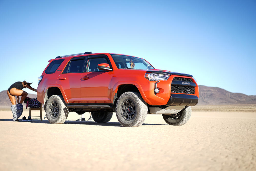

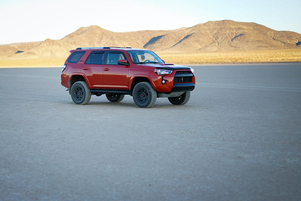

Went out and played around with the kit on the flats as well as speeding down some bumpy dirt roads on the way back from my photoshoot today... I was very impressed with the suspension and noticed almost no difference between the original and afterward with the kit. I even caught some air when i wasn't expecting it.... it was awesome. I don't have any pictures or video of all that, but here are a few before I dirtied her up....

[MENTION=99880]simonsay[/MENTION] Thanks for posting the pictures. The photos have really pushed me toward putting the kit on my immediate buy list.

In the pictures I posted, I didn't have the spidertrax installed. I should be getting them in today, but I may end up no putting them on.... we'll see. Some say it never gave them any problems, other think it's the worst thing you can do.... I don't get it.
I went through just about every comment I could find about them and found the same results. My opinion is they need to be installed correctly, run for a while and then check the torque on them periodically. What sold me on them was the people I saw on here that wheel them all the time with no issues.
Man, thanks for posting those pics, nice looking set up you have there! Your truck is pretty cool to, lol. :hiding:

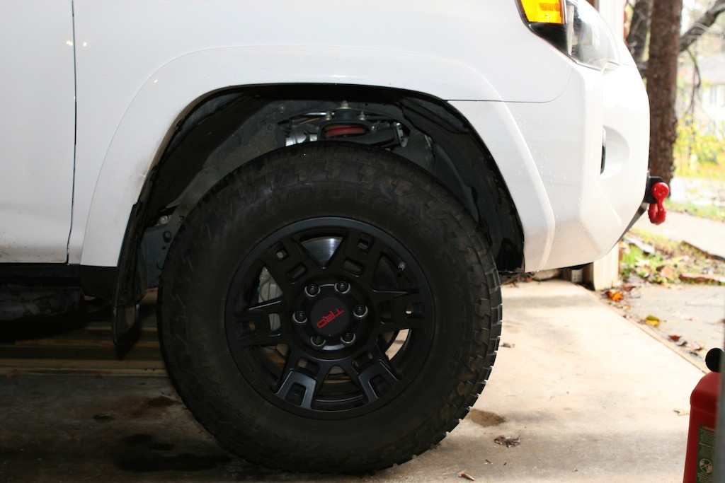

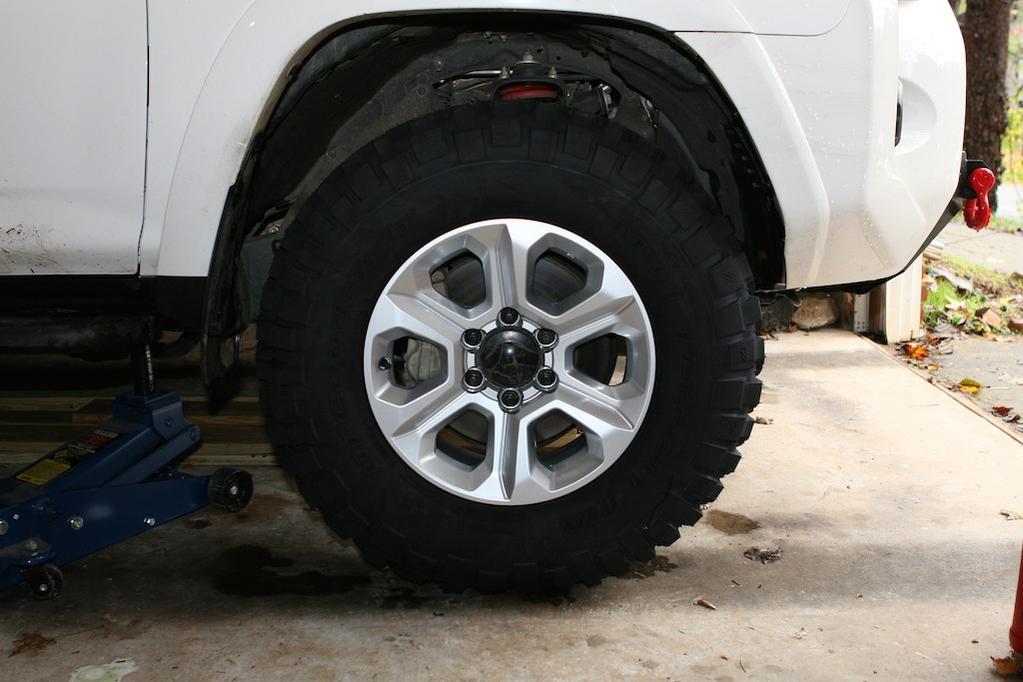

Better pics coming later but got these installed today: 255/80R17 BF Goodrich KM2's on a set of 2014 SR5 wheels to run as a second set. No rubbing/scraping either.
Measurements from front right only: Factory original Nitto Terra Grappler (non-G2) 265/70R17 (7 in wide wheel) with 20k mileage:
Height from floor to fender lip - 35 in
Height from floor to center of hub - 14 5/8 in
Tire/wheel off vehicle against wall - 31 5/16 in
New BF Goodrich KM2 with 2014 SR5 wheel 255/80R17 (7 in wide wheel):
Height from floor to fender lip - 36 1/2 in
Height from floor to center of hub - 15 1/4 in
Tire/wheel off vehicle against wall - 33 in
Didn't know about the new toytec option either....

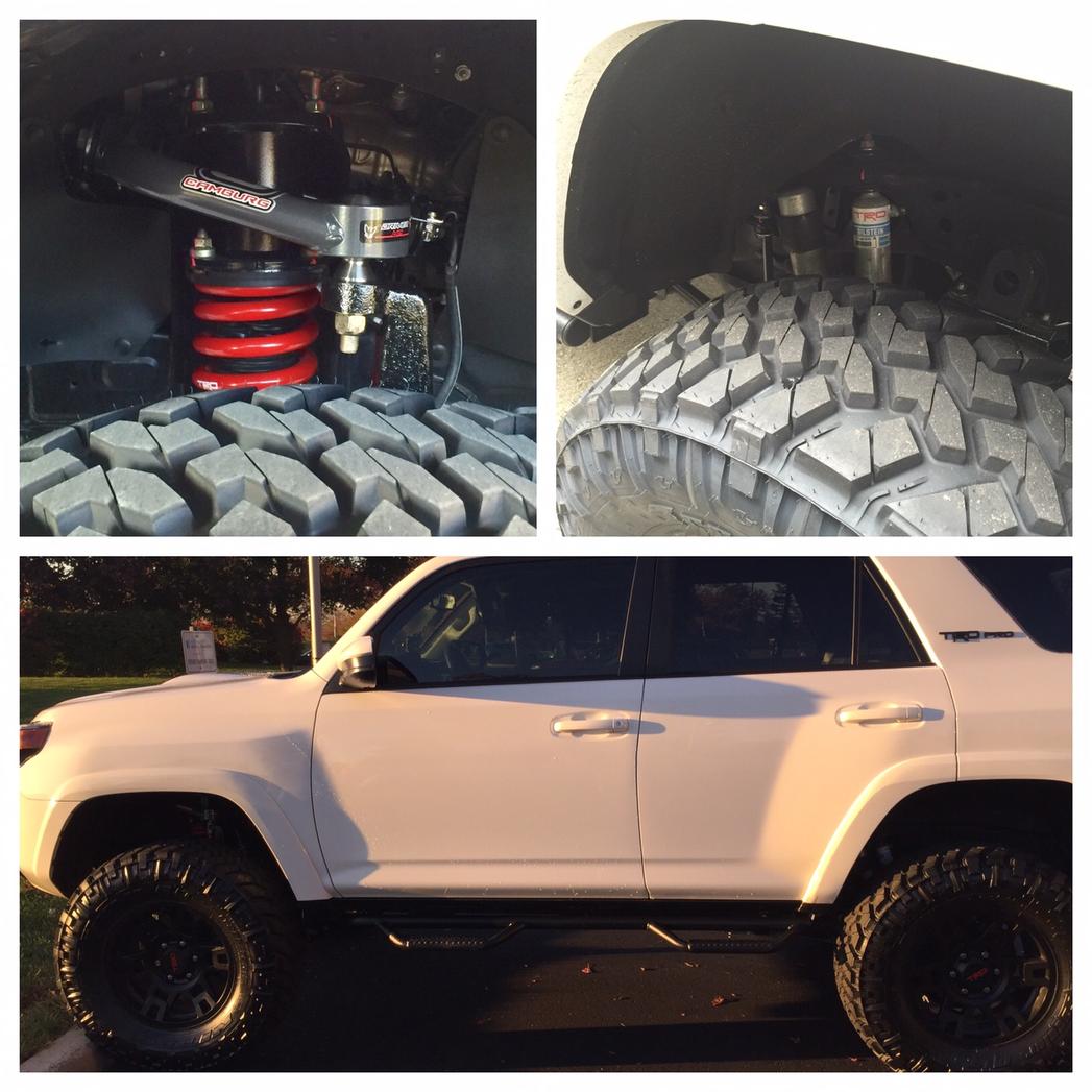

Just found this thread. I have kept all of my TRD components that were an upgrade from the trail. I did replace the OEM Knuckles and UCA for the lift. I will get my money's worth out of the Billies and then get something better when time to replace them.
Interesting note: The elusive TRDP "Clunk" is gone
Replacing the Nfabs if anyone is interested. only 8K on them.

Never had the clunk issue. Didn't even know there was an issue with it. What size tires are those and how is the ride?

Do you rub on lower body point with rear wheels on compression?
