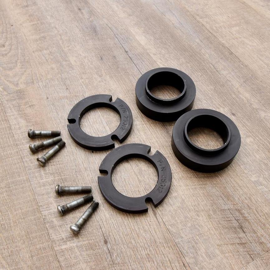

Anyone happen to have a set of preload spacers for sale?

Yeah i'm a big fan of Cornfed they make a great product but their kit is different than the ToyTec kit. They use a spacer between the top hat and coil rather than a replacement lower spring seat. Really not a big deal at the end of the day. I don't think they include longer studs for the top hat either or am I wrong on that? I haven't forgot you on this, just weighing all options at the moment.
Their .5" top hat spacer when bolted threads all the way to the top end of the nut, all the threads are secured. My mechanic buddy said it's fine and he didn't think it was necessary to buy extended bolts.
That is the direction I ended up going tbh. And why I don't have the spacers on anymore. I have the King 14" 650# springs. I removed the front sway bar, and cant tell a difference on the most twisted of roads. I want to sell my spacers, but my advice is to go with the Kings springs and don't look back.
