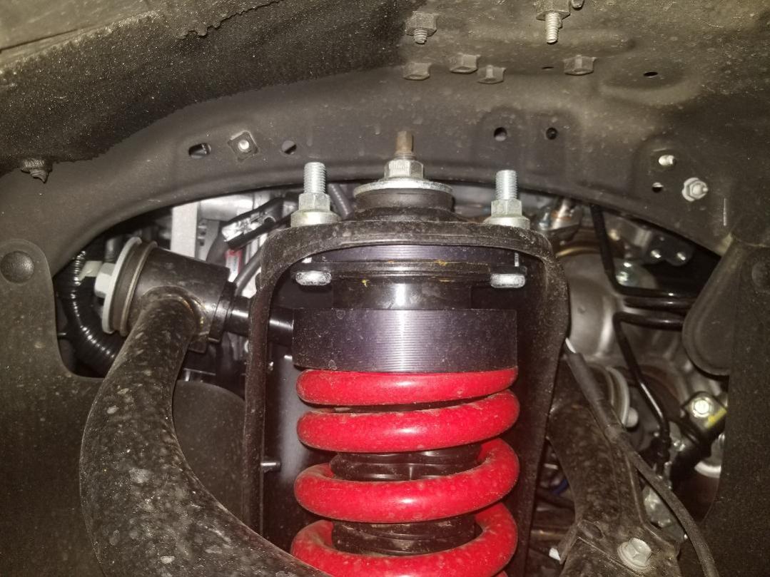

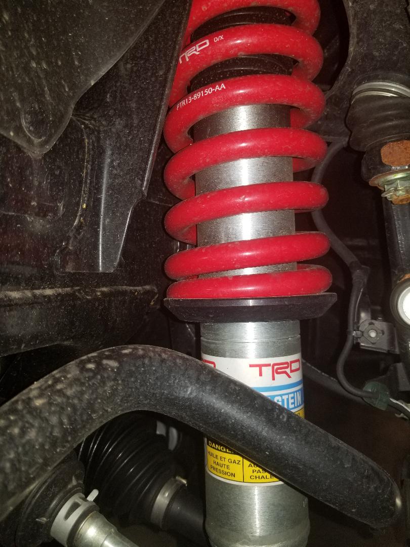

Can someone post a picture of the front coil post install of the toytec kit? I cant find install instructions and can't find a picture. There maybe one buried in here but didnt see it with a quick search.
I just noticed I have some reverse rake and my front from center of hub to fender is a hair over 24 inches which seems high.
Just want to make sure parts were installed correctly.

I hadn't because I havent been home but was thinking about it from another thread I read. Seems the TRD pro suspension plus the toytec trd pro lift should get you to around 23 inches front hub to wheel well opening. Mine is a hair over 24. I know each one is a bit different but that seems like a bunch, especially if folks are saying over 23 you really need to worry about CV
Yeah stock on a Pro is about 20.75 ish and 23 is about max you want to go before really getting worried about CV angles. Post up a couple pictures of your lower mount and tophat so we can see what's going on.
Here are some pictures....

Oh boy, yeah not right at all. That big thick spacers goes on the bottom not the top. You replace the OEM lower spring seat with the new thick spacer. I would not drive like that period. Fix it before you drive it again.

Nope nothing up top besides that thin spacer you have between the top hat and strut mount. You need to put the rubber isolator back in there between the coil and top hat when you have it apart again also.
I read something that said....
Includes front coil spacers which replace the coil perches on the stock shocks. Also includes front top plate spacers with longer studs.
So they need to take out the perch and put it on bottom and add back the rubber spacer? Seems like they may have put both spacers on top.
