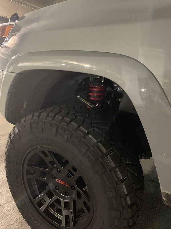

I think I might be the only only to do this specifically. I swapped the stock 4RPro spring with the FJPro spring. I got incredible height back that I had lost after adding a bumper. I will warn you this route more than likely will cause you to have to replace the stock UCAs. But I am overall happy with the look and it rides great on and off road. I’ll post pictures later if you need to see some.

I have tested it both ways, I started with the stock metal perch with the top hat spacer from the Toytec kit (still had a noticeable factory rake). I am now using the bottom 1" Toytec perch and the top hat spacer. Rake is pretty much gone as I don't tow or load up the rear for long trips. Last I measured with the 285s I was at 39" (ground to fender center) up front and 39-1/4" rear.
FYI I am running the 1.5" SAWs in the rear, which many have reported sit more around 2.25" unloaded.
