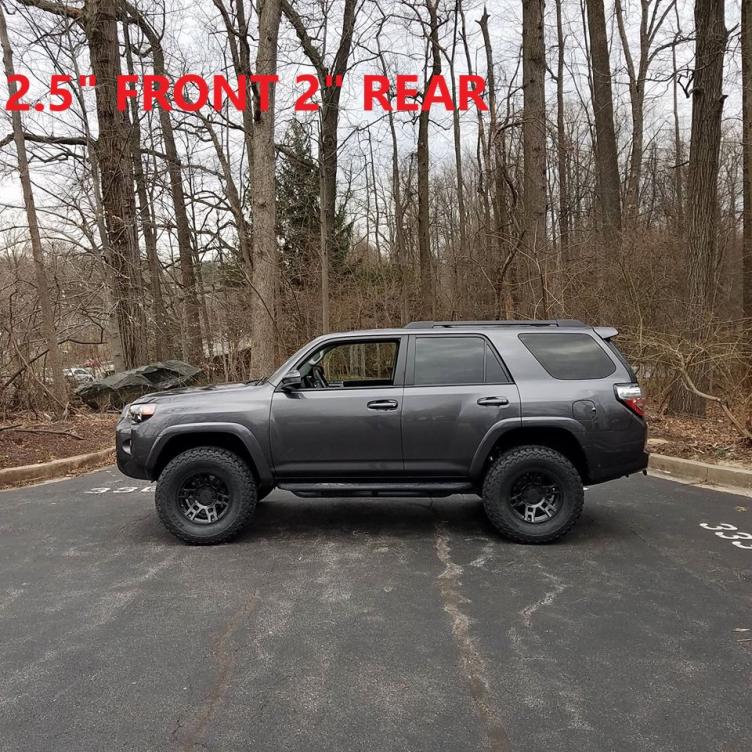

You're one of the few in that boat. Larger tires are very obvious. I'm running a 295/70/17
So I just need a 1.5 inch front suspension spacer then?
