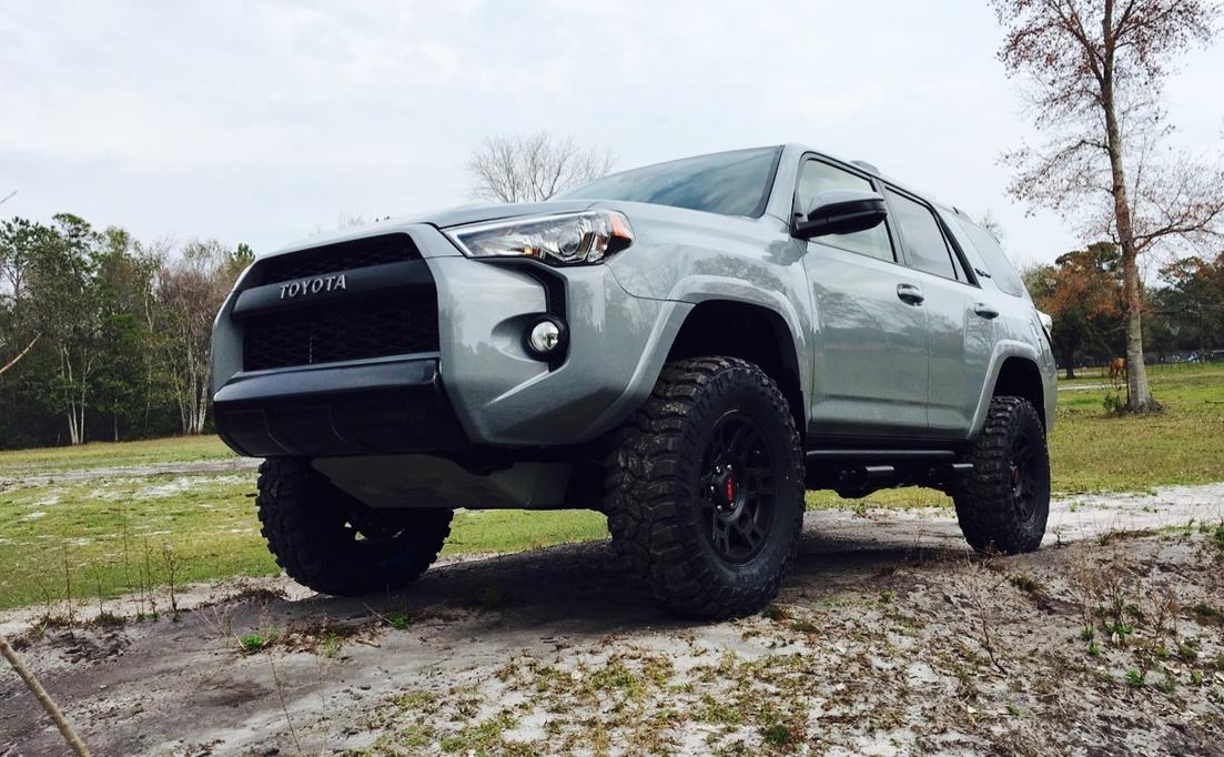

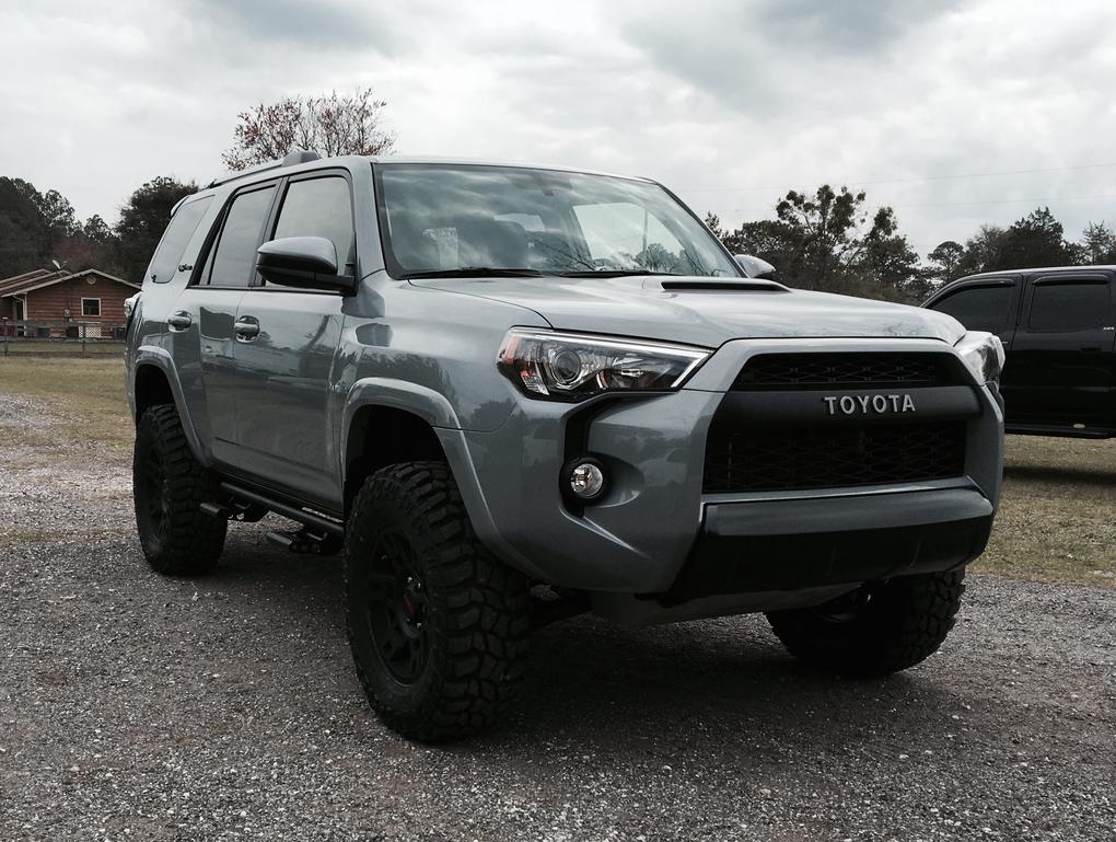

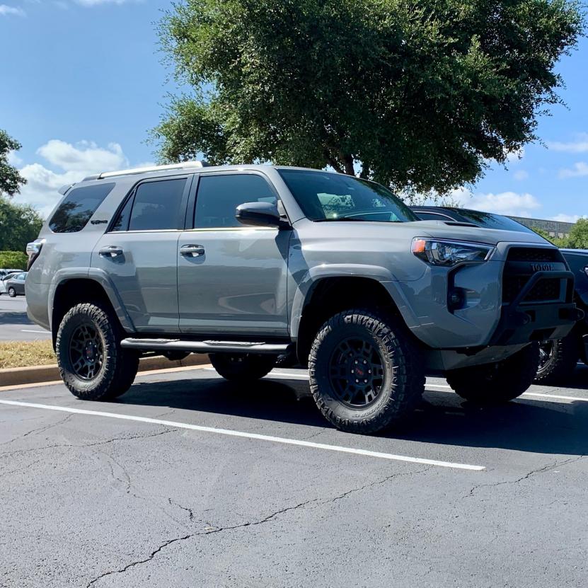

Here's a 2.25/2 for fun, can also do this for ya:
242501d1489160840-lift-leveling-kit-holiday-season-sale-img_6470-jpg
242503d1489160934-lift-leveling-kit-holiday-season-sale-img_6467-jpg

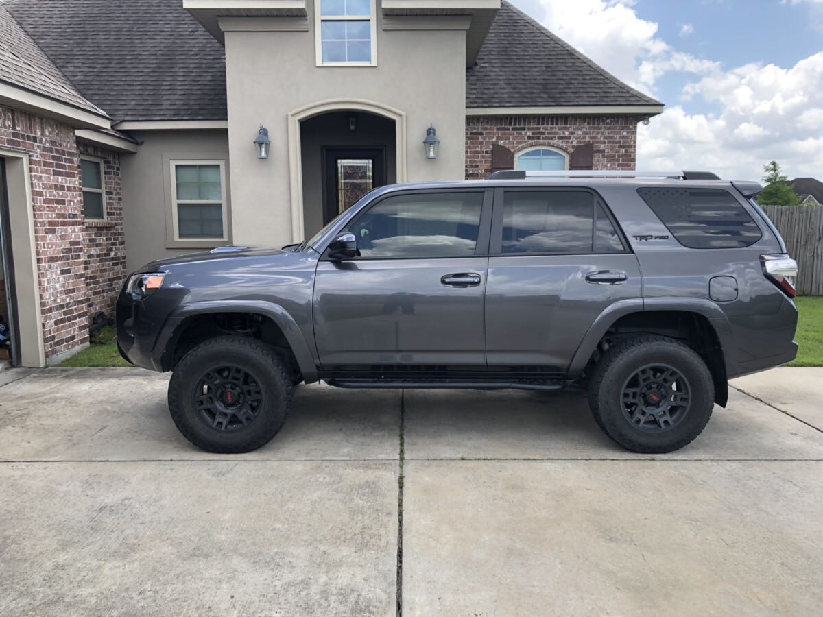

Here's the 2/1.5
338899d1563031168-lift-leveling-kit-holiday-season-sale-img_3817-jpg

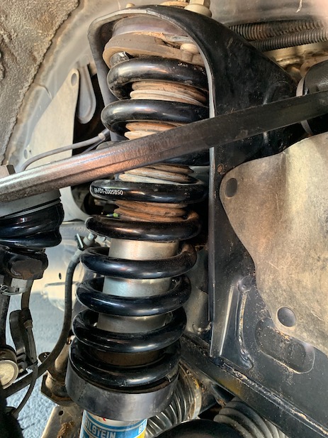

Maybe I'm confused, but aren't both the top and bottom spacers acting as preload? They both take up space inside the coil perch -- the bottom spacer replaces the stock spring perch while the top spacer sits between the top of the spring and the subframe housing. Both seem to me to preload the spring?
The bottom spacer I have and top spacer I used to have installed.
I attached a picture of both spacers installed before I removed the top one.
Edit: Ok I was confused -- the top spacer isn't a preload. I see now that it sits on top of the coilover and not inside it.

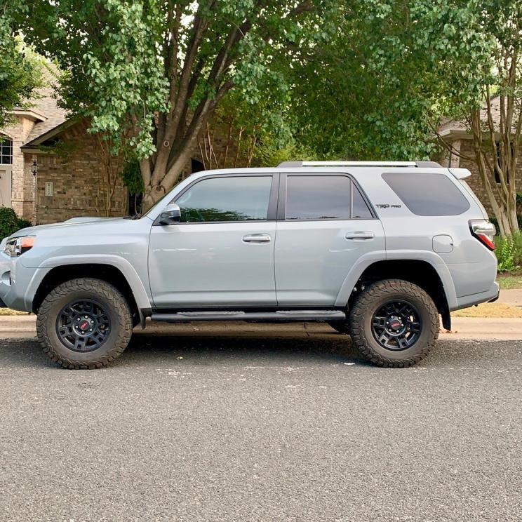

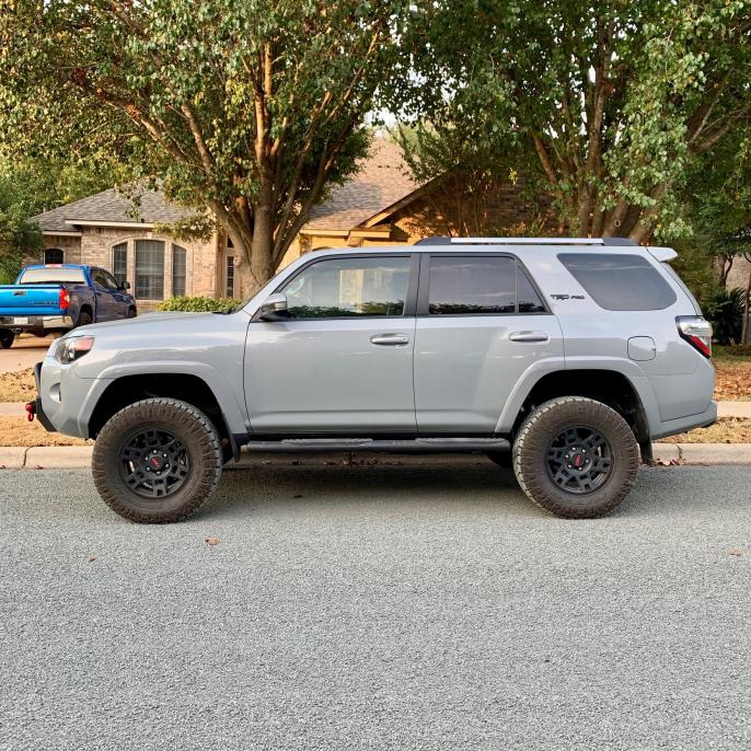

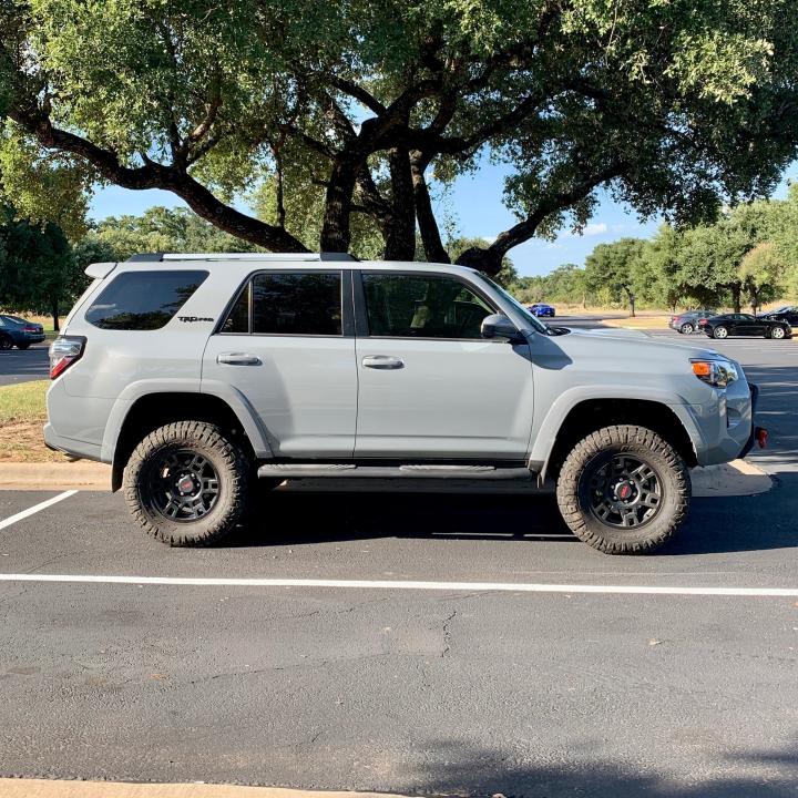

In case anyone was curious, I have a few pictures of my trials and errors.
The 14" springs + Toytec spacer lift combo was definitely too much and had a slight negative rake.
The attached pictures in order:
Toytec top and bottom spacers, stock suspension
Toytec top and bottom spacers, Bilstein 14" x 600 lb springs
Toytec bottom spacers only, Bilstein 14"x600 lb springs
Toytec top spacers only, Bilstein 14"x600 lb springs
