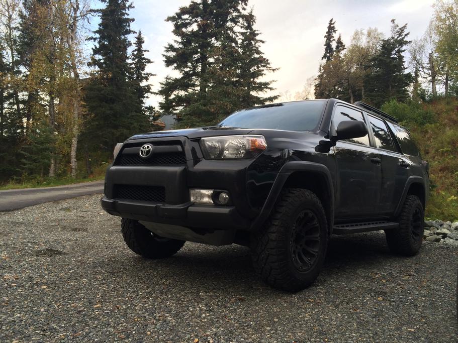

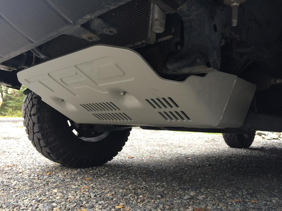

I just ordered this for my 2012 trail non-kdss and will report back on fitment. Part guy at Toyota said it should work as the factory "skid plate" is the same for 2010+. I get it next week, will report back, hopefully with pics of a success :dance: I paid $275 and I'm in AK.

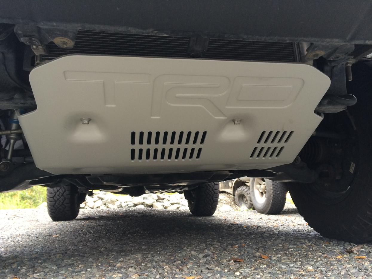

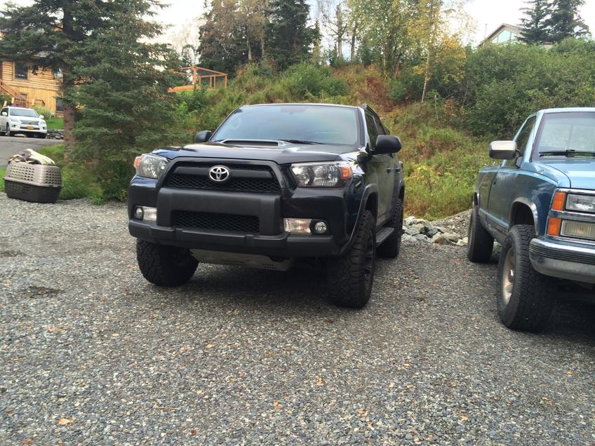

Got the skid plate in today...here are a few pics!!!

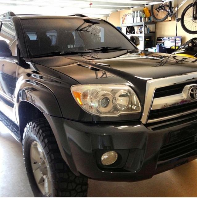

I work for Toyota but am not able to purchase parts as of yet. Just went into warehouse to check them out. I believe they will be available real soon for purchase. Look awesome though. Seem to be made very well cannot wait to get a set and test them out. If I get them soon I will be more then glad to do a full review. I really would like to add them to my runner and run 285s. I really want to know how much lift is actually gained. I have measured mine and there is a 2 inch spread from front to back. Seems to look like the trd pro is nose up.
You think 285s will fit with the TRD PRO suspension? The stock tires on the TRD PRO are 265s, right? Just looking at the pictures of the pro it looks like there is enough room that 285s would fit.
I'm thinking they will for sure fit. Looks more like a 2 inch lift. Stock offset should be good for 285. No one is running a 2014 trail wheel with a 2 inch lift up front So I have no idea. Everyone on the forum lifts the back higher then the front. I would like it to sit like my old 4runner.

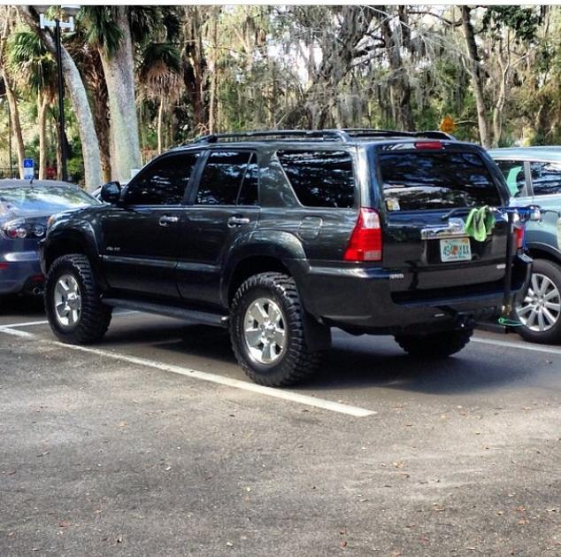

OlD 4th gen
I liked how it sat. Had 5100s at 1.75 and a 2 inch top spacer with diff drop. 285 km2 with spidertrax. Airlift in back.

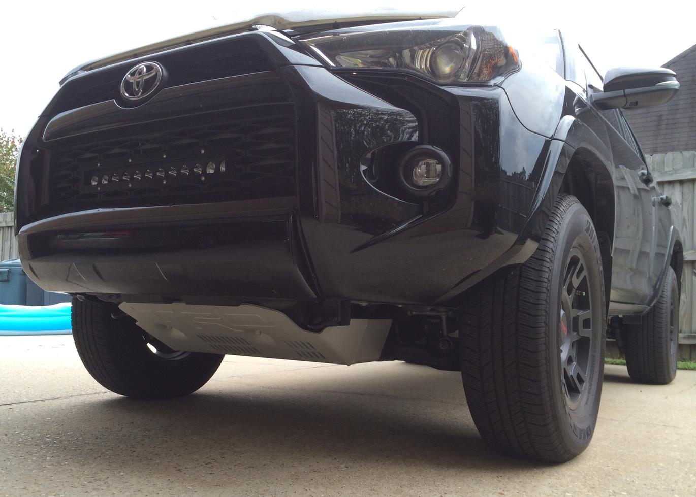

Skid delivered today.
Appears all mounting hardware is inclusive for those with questions.
Decision to be made, plastidip it black and leave TRD undipped or leave as is!

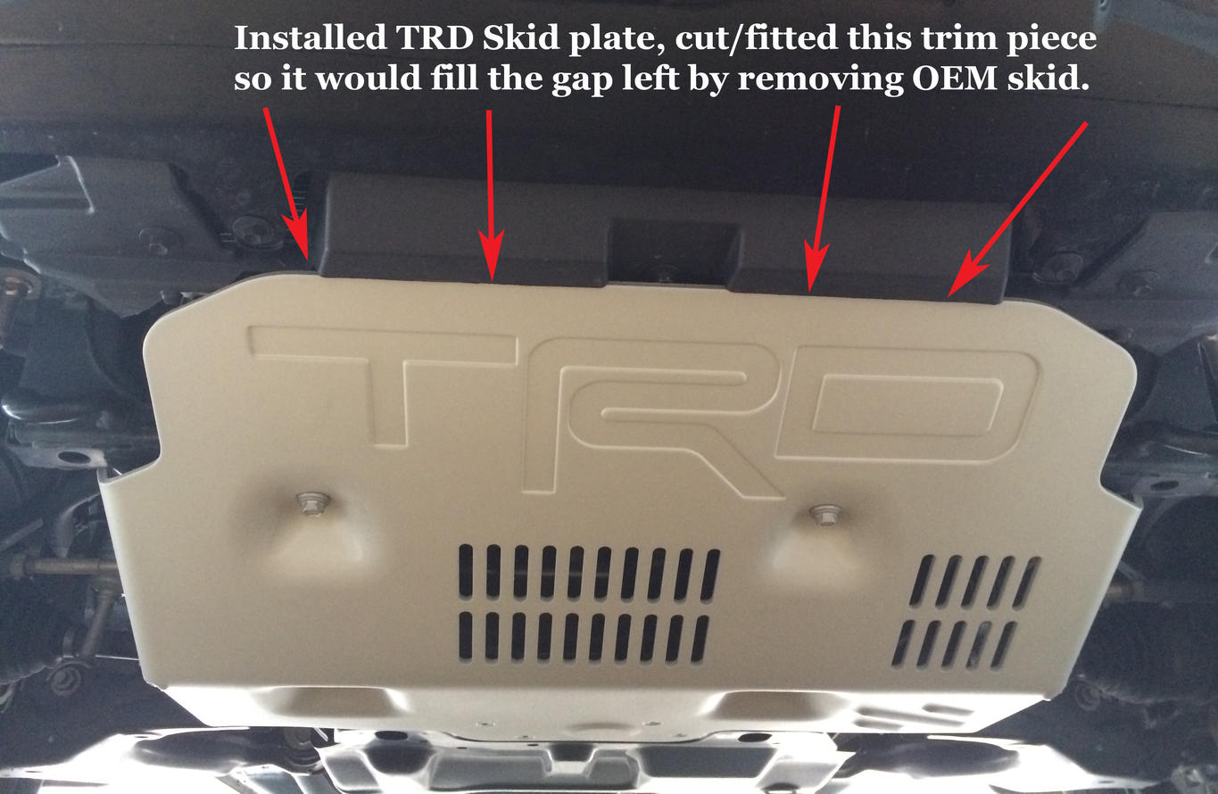

Finally had time to install my skid plate.
Upon first trying to install the skid, I found there was some abnormal resistance while tightening the front passenger side bolt on the skid.
To avoid a bad issue, I went to my local hardware store and picked up 2 items.
M10 X 1.25 bottom tap and a M10 X 1.25 hex die to chase all bolt holes and chase the threads on the bolts to make sure I would have no issues....
Put a small amount of never seize on the bolts and all went well.
Instead of discarding the front plastic trim piece, I decided to cut/trim it so it would fill the gap left between the bumper cover and the new skid plate.
Worked like a charm!
