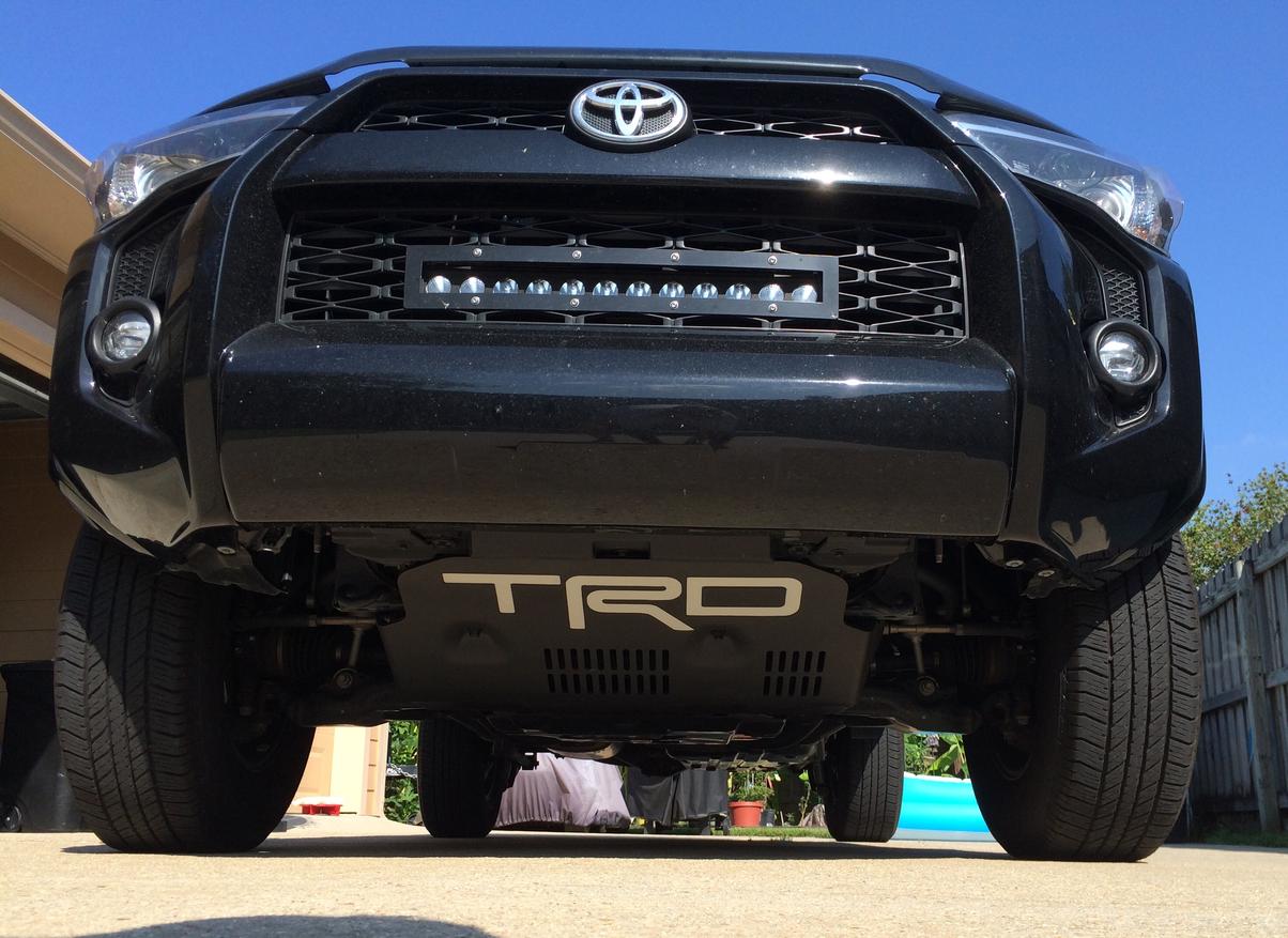

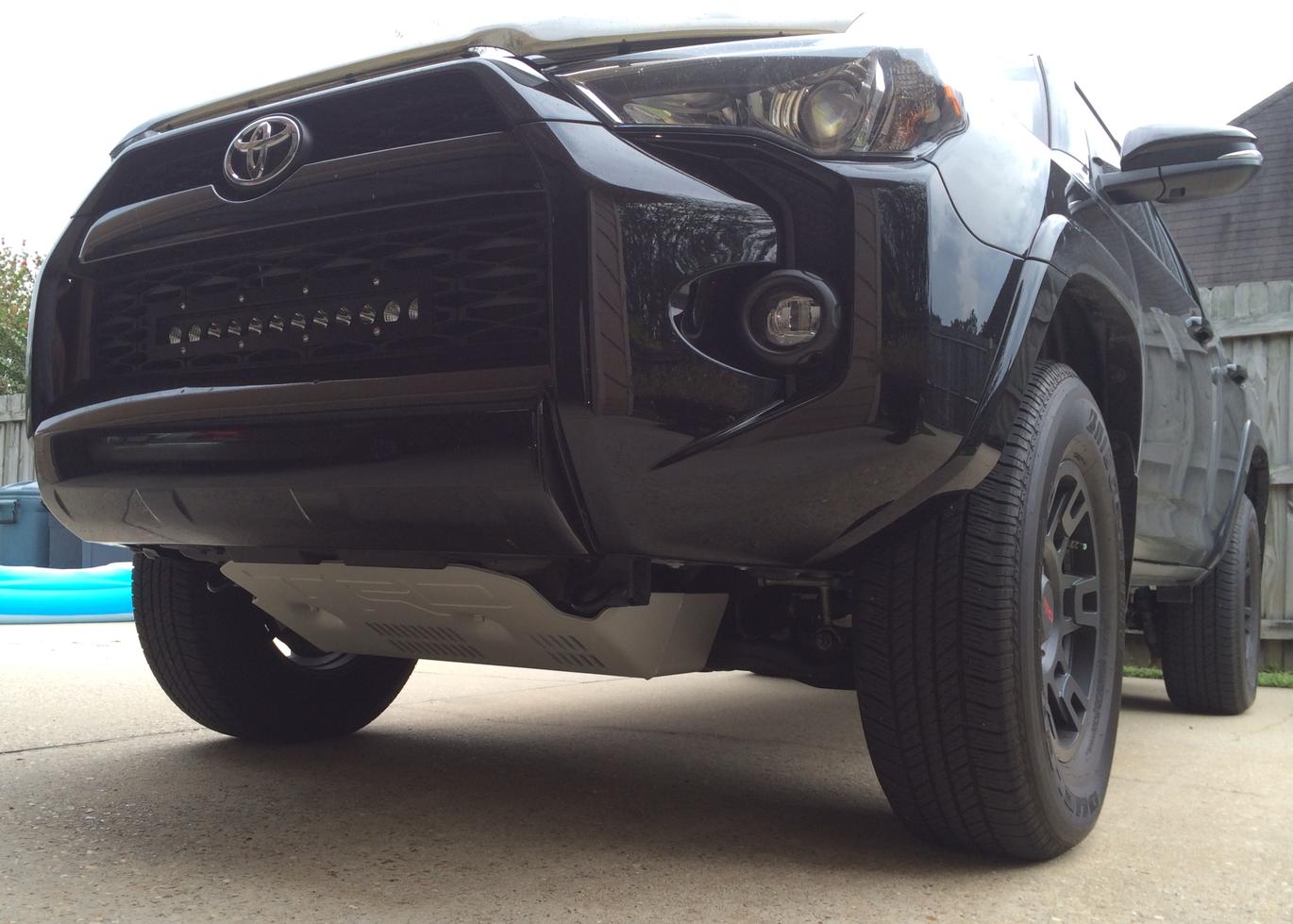

Plasti Dip TRD Skid
Ok, I made a change to the TRD Skid plate & I like this better.
I PlastiDipped my plate with black.
See before and after pics:

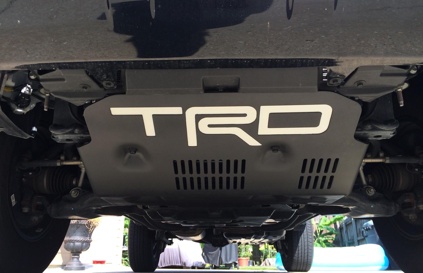

Finally had time to install my skid plate.
Upon first trying to install the skid, I found there was some abnormal resistance while tightening the front passenger side bolt on the skid.
To avoid a bad issue, I went to my local hardware store and picked up 2 items.
M10 X 1.25 bottom tap and a M10 X 1.25 hex die to chase all bolt holes and chase the threads on the bolts to make sure I would have no issues....
Put a small amount of never seize on the bolts and all went well.
Instead of discarding the front plastic trim piece, I decided to cut/trim it so it would fill the gap left between the bumper cover and the new skid plate.
Worked like a charm!

Saker,
Do you have any pics of the plastic cover that you cut down to size without the skid? I just received my skid and was thinking about just removing the plastic cover all together.
Saker,
No @slyangel. I don't. the only one I have is pictured, if that is what you are asking.
Otherwise, there are pictures on the net of the TRD Pro 4Runner that shows the gap.
Or maybe someone can snap a pic for you with out the filler piece.
You have to remove it and the oem skid first anyway, install the TRD skid and look at it. I leaves gap in the front that was covered initially.
IMHO, for T4R owners wanting to install the TRD skid , Toyota could have included a template to cut down this piece and re-install.
I just installed the skid, placing the cover and marking to get a estimate of where to cut.
You may be able to make a cut template out of cardboard to get your pattern.
Either war, you will have to trim a couple of times to get it right, just don't get in a hurry, utility knives are sharp! (No, I didn't get in a hurry or cut myself!!!)
I was fortunate to get my fit as close as it is. It's as close as it looks in the pics.
BTW. once installed, this never has to come off to drop the skid for oil change!
