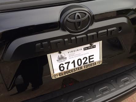

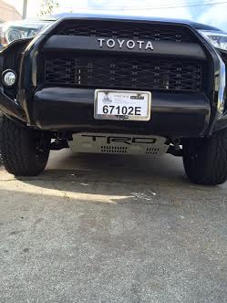

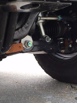

So I removed my skid plate to paint the TRD logo and I saw some rust. Truck only has 200 miles on it.
Any one else have this problem?
Some pics of my painted skid plate and rear emblem.

Those pictures of the rusty metals pieces are cast iron, those parts always look like that. There is very very thin layer of surface rust on them.

Yes, it's normal. As others said, cast iron parts that aren't painted are going to have surface rust on them. That surface rust will never "rust through" in your entire life time. but if you want them to look nice, go ahead and get a wire brush, clean them up, spray with a good marine grade high bond primer and top coat them. It may still come back eventually but it's really cosmetic.
The frame welds rusting bother me a bit more because they didn't use to do that so quickly. I think they've thinned their e-coating a bit.

What you have there is a normal 4Runner.
It's cast iron and came across the ocean on a boat that wasn't hermetically sealed. Anything of this nature will show up with surface rust even prior to use.
This "condition" does not and will not ever adversely effect the functionality of the vehicle and since cosmetic warranty items usually have to be visible from the driver seat during normal use or 10 foot of exterior while walking around the vehicle... crawling under a vehicle to see some surface rust does not qualify for warranty as it is intentionally designed this way. Get over it and find something else to complain about... jeese
