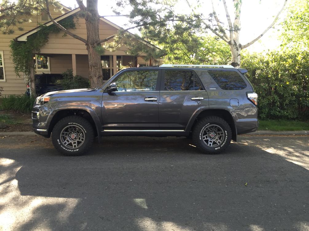

Well all done and I ended up doing it myself this morning. Took about 5 hours with a one hour trip to the Les Schwab in town to have the springs compressed. I had it aligned there as well.
The 4 x 4 shop that I was going to have do it was closed today. So I gathered the stuff and got it done.
I found some great stuff here on the forum for disconnecting the Xreas. It was about the easiest part of the whole job. I left the lines installed for now.
The hardest part today was getting the bottom bolt back into the shock on the pax side. It was a royal pain.
The truck sits level as far as wheel well gap but looks a bit nose high. The front shock spring perch's are set on the third groove. Going to drive it a few weeks and decide if I need some spacers or some springs. right now the 5160's are using the stock springs. I'd still like to have a bit of a rake to it.
Thanks for the help
Phil
