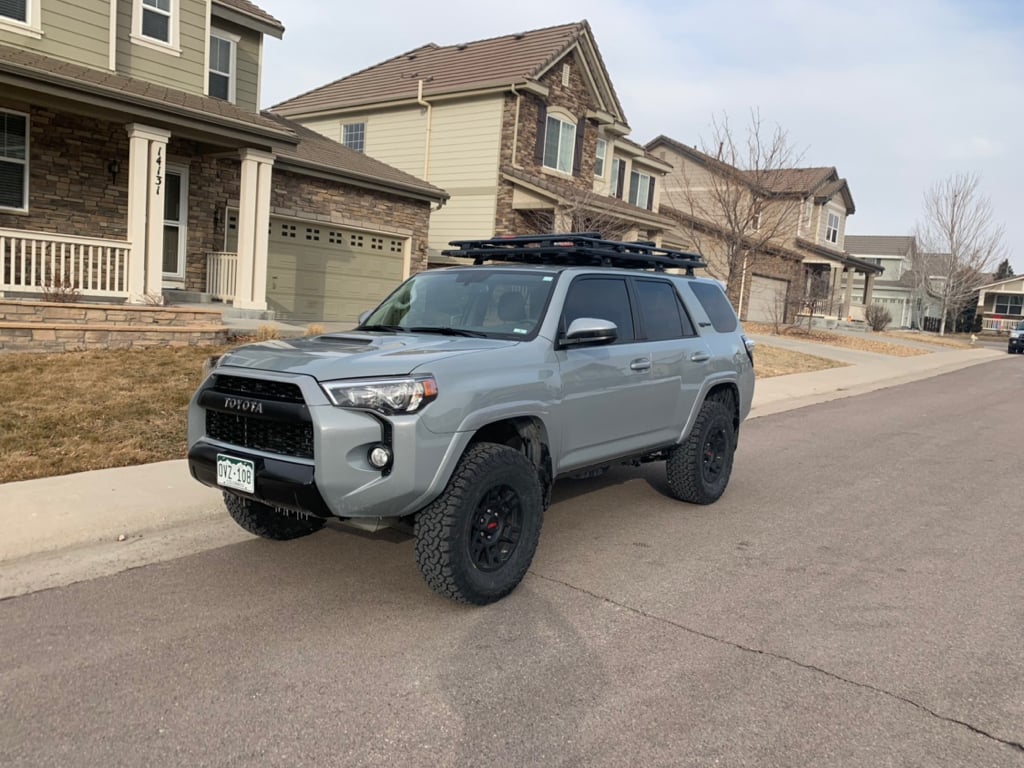

TRD Pro with 6112 coils (pics inside)
Any concern with down travel and topping out the factory shocks, front or rear, with this setup?
How much did you lift your rear? I'm looking to add a similar setup to my 4runner and wanted to compare.
No clip setting. The shocks are from a TRD Pro. They have no clip settings like the 6112 shocks. The rears I kept stock. Same as the front, just replaced the coil.

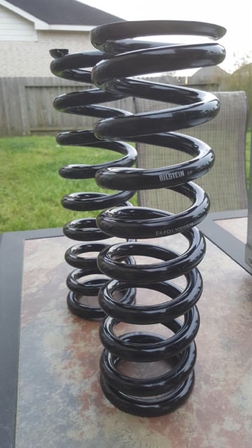

ah so you went with the 600 pound coils that are an inch longer 3x14 from 3x13
That is correct. I used the coils from a Bilstein 6112 kit.

Interesting, I am running 275's on my 2018 Pro with the stock Bilsteins and 1.5" top hat spacers and I don't think my wheels stick out anywhere near that much. I like the look.
I don't think they stick out that much. Here is another shot.
I'm really digging this setup. Will you have a chance to get it out offroad soon? Dying to know how it handles off road with those coils.
Did you have to trim anything for the 285s?
Nothing yet but I have not gotten a chance to flex the suspension. No rubbing at this point.
As soon as I get a chance I will post my opinion in this thread. On road, the suspension feels almost stock with just a little bit more stiffness and less nose dive.
Could you do the measurements from your center hubs to fenders? This will eliminate the tire height. You are right at 3" taller then me completely stock. Thanks.
Sorry for the delay. So the front I measured just couple notches over 22 3/4 and the rear I measured 23 even.
Looks great! What rack is that?
It's a Rhino Rack.
You will really enjoy this set up. I think it's the best way to lift a TRD Pro without spacers or spending extra money on a whole new suspension. TRD Pro owners already paid for a sweet suspension from factory, why rip out the whole package.
Got my set of springs in yesterday!!
