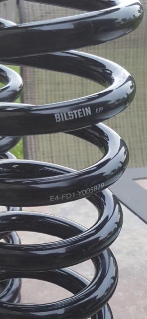

P/N for Coils
Hey [MENTION=75956]speedyglx[/MENTION] & [MENTION=303056]Bayou_Pro[/MENTION]
For reference, what is the p/n for the bilstein coils you are using?
E4-FD1-Y005B29?
E4-FD1-Y005B29?
Yep.
