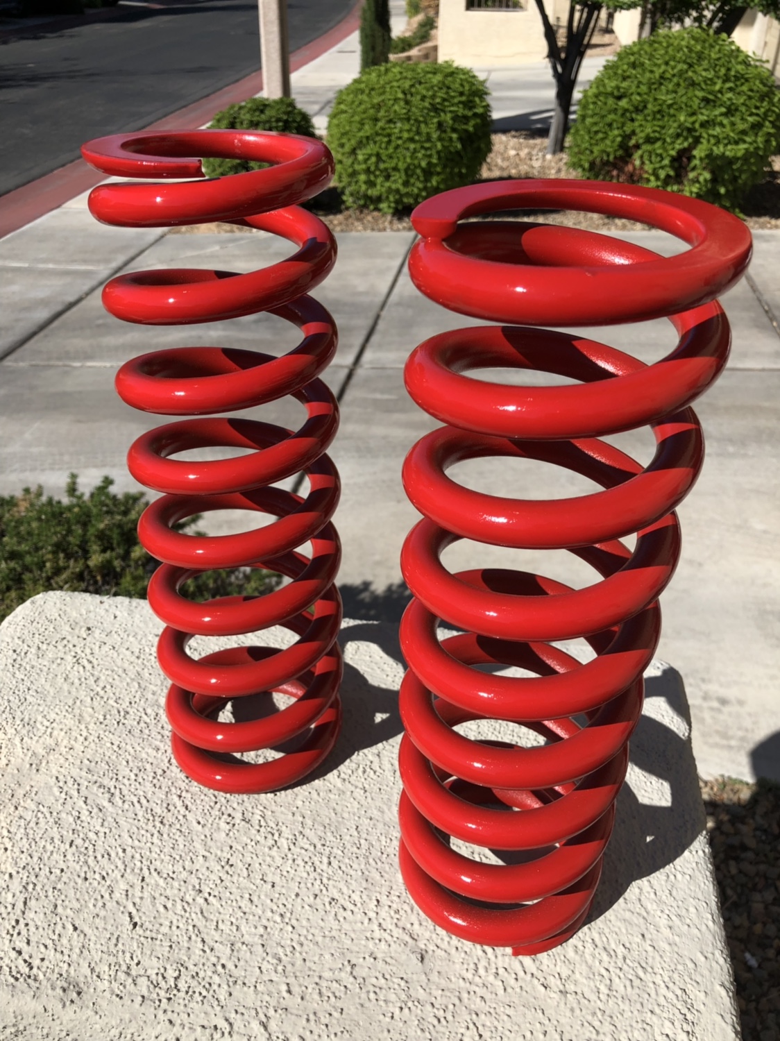

Perfect, looking forward to hearing how it went... build pics maybe? What did you decide to do with the rears? I finished painting my coils red and they look pretty good for rattle cans:
Looks good. Yes I'll take a bunch of pics. I'm using a set of Dobinsons 599 on the rear. Supposed to be about 1.25" lift. I want it pretty level just a bit higher in rear.
