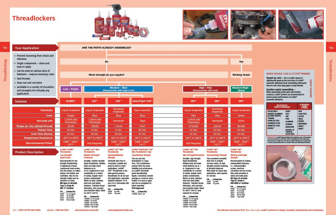

There are many grades of Loctite red, some require heat to remove, others dont. Blue is ok ive used it for years on various parts. I use to use alot of Green in specialty transmissions as well. This chart only has a few of their range but you get the idea. I think blue for most parts with red for specialty stuff

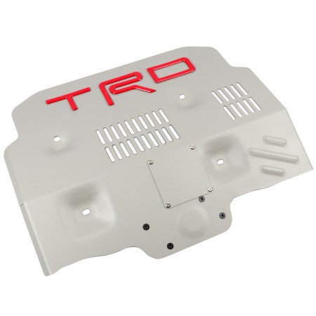

did an oil change at 7500 miles interval, I have a the trd skid plate and the front push nut bolt retainer was broken from a previous oil change. It wasn't too difficult to line that up. One bolt in the rear wouldn't go in all the way, so i had to rethread but it works now.
Oil change took about 15 minutes besides the rethreading.

I got an even better ideA. Run the trd pro skid plates with an oil change door and call it a day.
Takes me 5 min to do an oil change….
