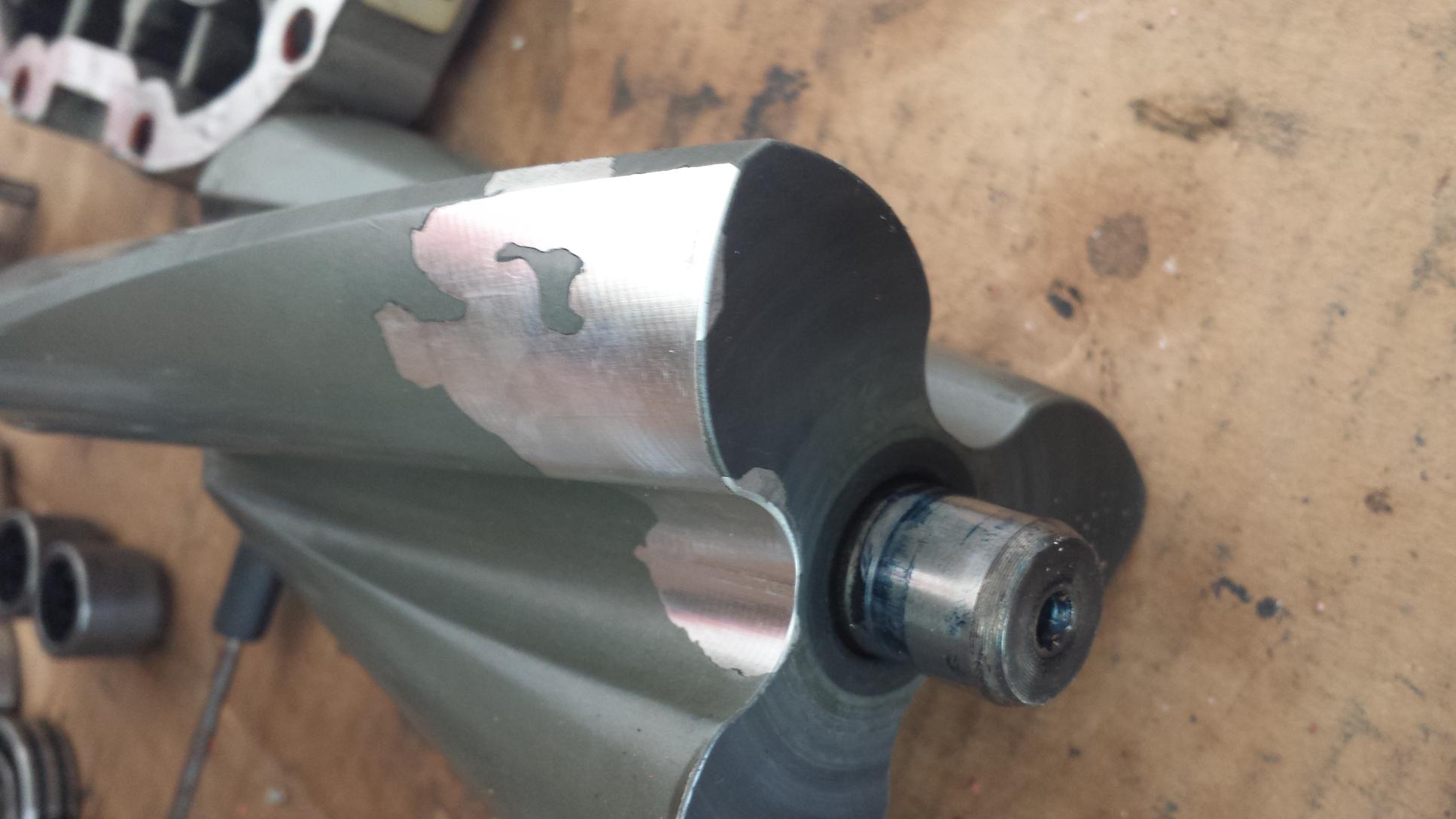

02SE here is a pic of my rotor. What would you suggest I do? Strip the coating or run as is? If I run as is, I'm worried if getting flakes in the engine and causing problens. I'm not trying to squeeze every ounce of HP from the engine, just be able to go over the rockies without shifting into 3rd gear!!

It's up to you. If you run meth the coating is going to come off. Yours will continue to flake off as it has already started. The earlier M62 chargers didn't have the coatings. You can get them recoated if you want, but it isn't cheap. In the whole scheme of rebuilding superchargers, it is a relatively minor concern IMO. Getting the tolerances and everything to fit together correctly is much more important.
Personally? I would get it re-coated. But I'm very picky that things be done correctly.
I agree that the tolerances being correct is important for the best performance. However, the tolerances won't be what they should be, with the coating removed.
I've rebuilt Superchargers hundreds of times. In our application, cutting corners, or just average performance, is not acceptable.
In our case, as soon as the data-logged pressure starts to drop, the Supercharger gets rebuilt. Or if too far out of spec even after being rebuilt, it gets replaced.
So with all that being said, If less-than-optimal performance is acceptable, then be assured you won't hurt anything with a less efficient Supercharger that's not producing pressure to it's full potential.
since you have rebuilt plenty and seem to have a handle on this, where is the most economical place to get these recoated. and what will the damage be?
keep in mind, this is a budget build to get myself a little more power, but then again this is going on an engine w/ 218000 miles on it that will not be rebuilt. I am obviously not going to be checking pre and post pressure output to determine a rebuild schedule!
One more for you. What are you thoughts on my idea of just running a 2.1 pulley w/ stripped rotors versus running a 2.2 pulley w/ coated rotors? Again, seems like an economical solution to go w/ the stripped/2.1 combo.
Thanks for your help guys!
I don't deal with the street oriented Eaton superchargers much. But I have heard good things about this place from those that do:Supercharger Rebuild Services from Embree Machine at the The High Speed Lab, Eaton, MINI Cooper S R53, Powerdyne, Kenne Bell & Whipple Supercharger Rebuild Services & Supercharger Kits
Yeah, short of our pro drag racing application, where every little bit of performance matters, that would be overkill. :)
Well, without the coating on the rotors acting as a thermal barrier, the rotors will get hotter, thus the air will be hotter too. Then you're also spinning the supercharger faster, increasing the air temp even further.
Hotter intake air temps are never what you want for performance. How will it perform?, I can't answer that without testing the set-up.
I can only say for sure that a Supercharger built properly and running the correct tolerances, will perform better than one that isn't, all else being equal.

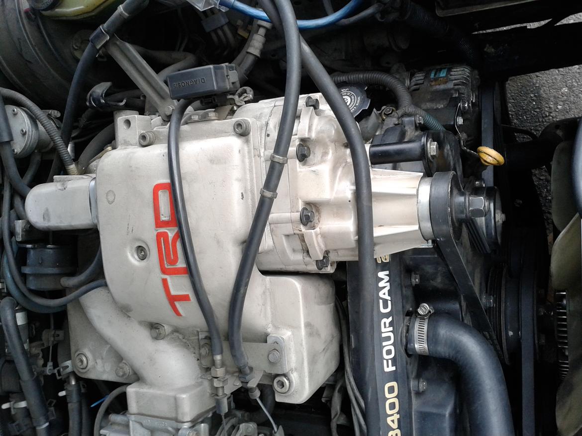

I have a limited 98 Toyota 4 runner that I bought 5 years ago and it already came with the supercharger and just recently started making noise.fixed the noise problem but just can't seem to figure out how to put in New oil can you help? I don't know how much it what kind.

Due to the location of the oil drain plug on the 1st gen superchargers you will have to remove the supercharger from the vehicle to change the oil. It's kind of a pain, but not a hard job to do. Once it's off there is a small port under the nose cone that you remove and drain the oil from. I suggest you replace the coupler in the supercharger as well since it's probably getting old. Check the instructions in the first post of this thread for how to get to the coupler and where to buy it. Also I would get two bottles of GM supercharger oil off Amazon and you need about 1 1/4 or so bottles for the refill.
