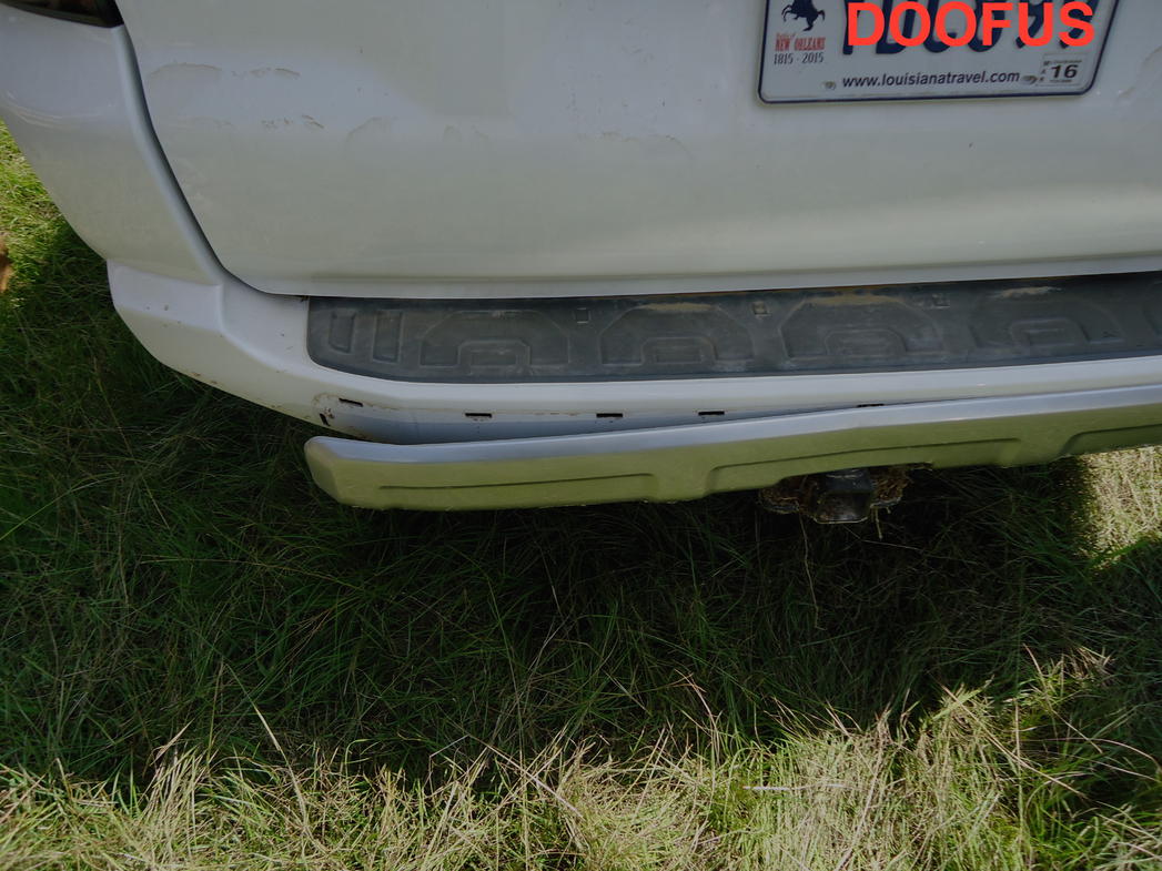

My plan was to try and improve the approach and departure angles for off roading without having to replace the front and rear bumpers. I started by installing the Bud Built Rock sliders and trimming the rocker panel to mold around the slider for a more OEM look. After doing that, my front and rear bumpers seemed awfully low compared to the rocker panels since I removed almost 4 inches off the bottom of the rockers. So I whipped out the jig saw one more time to try and even out the body lines, so tell me what you guys think.

you should get rid of your hitch shackle if you are really concerned about your departure angle, the stock departure angle is limited by the hitch and you've made it worse
He just needs to cut off the excess length and drill a new hole in it to keep it flush with the end of the hitch.

Speaking of RCI skids, I'm selling mine. I just bought them last month, but some family issues came up. They are NEW IN BOX, and are bare metal 3/16 FULL underbelly skids, Front/Mid/trans/t-case skids. Asking $500 plus shipping. I need money asap. In regards to the blade type, I used a laminate/wood blade, it provided a really smooth cut, I barely needed to sand the edges. I did use some blue masking tape just to make sure the cuts were as clean as possible. As for why I did it, first off it was free, and I hate how low the SR5 bumpers are to the ground, also when I go wheeling in pretty good at making sure I don't smash my bumpers. If there's anything more then a 70% chance of me scraping I just take the easier route. Please call or message me if anyone's interested in the RCI skids, 360-259-1103 or [email protected]
