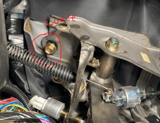

My truck (2000 t4r) has been having a hard time shifting into 1st for at least a year now. Recently started having trouble starting with clutch so I had to use the bypass button. Just checked and turns out this bolt was loose. Fixed the starting issue so far. Haven't driven it, yet. Hopefully will help with the shifting, too.
