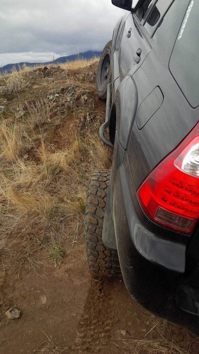

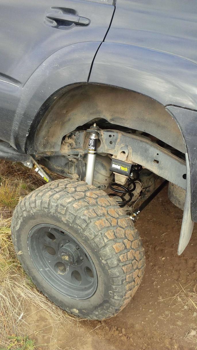

Fun Pics
I know these don't help solve the problem but these were taken a few minutes after the pre-runner testing. She still crawls normally.

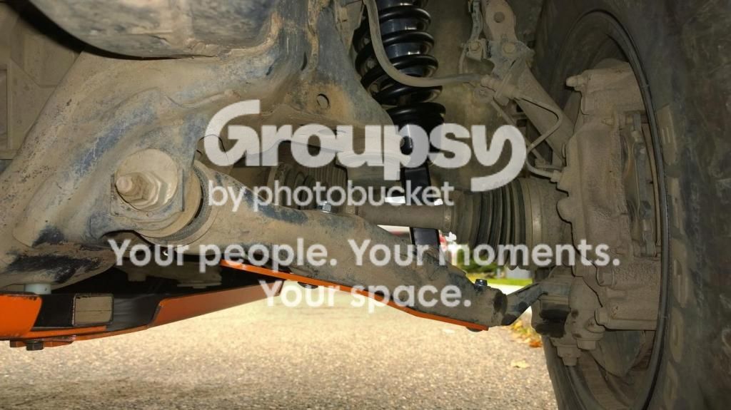

In one of the first pictures you posted, on the passenger side, it looks like the bushing on the lca may have torn or something. The arm doesnt look like it alligns with the bushing. Might wanna check that, as that would give you some negative camber.
passengerrearcambolt_zps3fb06423.jpg~original
I think I have the lean fixed. I put rear 1.5" spacer back in the rear drivers side. I used it with the previous lift to correct 3/4" lean. My current lean was 2". It brought the back up almost 2". Then cranked the front drivers 3 turns more than the front passenger and everything leveled. I think that sounds like it should be fine since I had the rear spacer in before. It just doesn't make sense the rear spacer corrected a 3/4" lean with a toytec bilstein lift and almost 2" on this lift.
