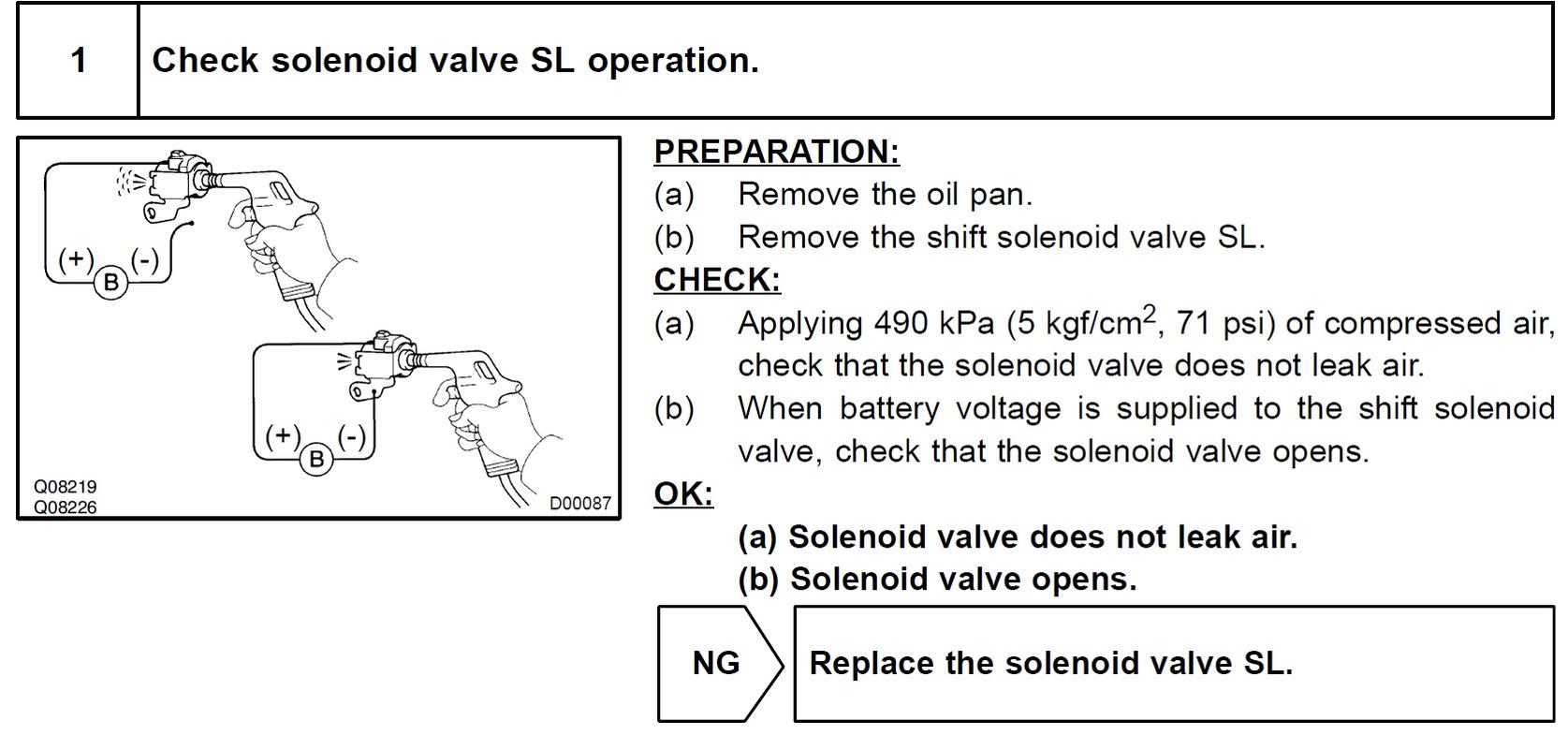

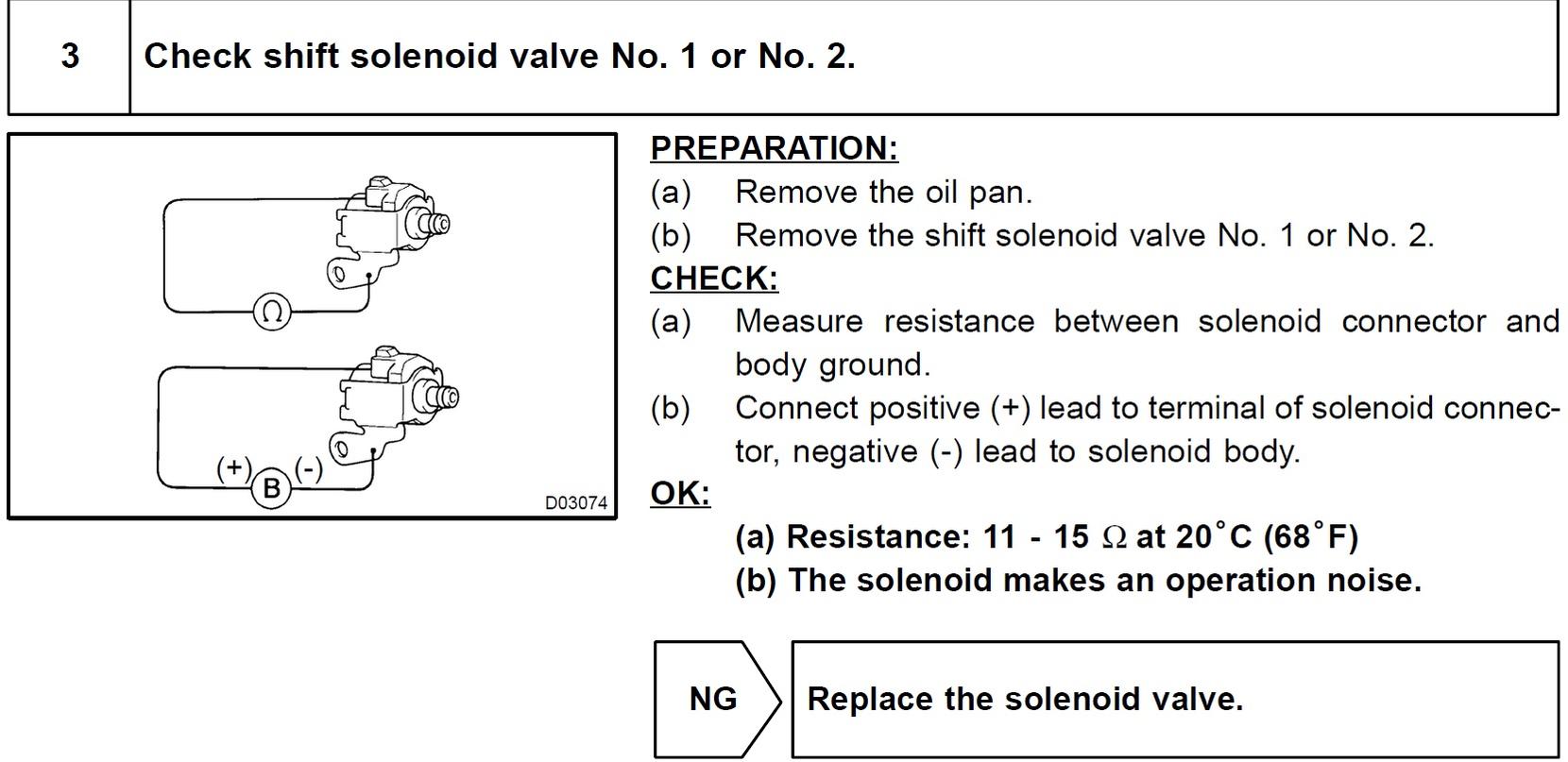

Here's some FSM pages about testing solenoids.
That's a very complicated testing procedure!
