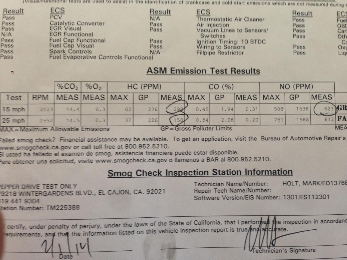

So i have a 1995 4runner 3.0 4x4 its time to take it to smog it, and it runs great no miss fire and i am so confused on what can be the problem they said my truck is a "Gross Pulitoer" think i spelt that wrong, but anyways can someone help me.

and i think its the CAT but not sure, but i did order one and hopefully thats the problem, anyone else know why?

I recently went through the same situation with my 4runner. I passed after replacing the cat and cleaning the egr system. You should also check fuel pressure and see if you have a stuck injector (possible cause for the rich condition).
You also might be able to lean it out by adjusting the air flow meter.
Catalytic converter. I think my readings were similar to yours and they told me the cat for sure. I replaced it and on tuesday, I passed.

is it possible that i put the o2 sensors on backwords? runs better after putting the cat on this morning, but what are the signs of backwords 02 sensors, if they are backwords, ill be switching them tomorrow.
i replaced my cat this morning, runs a little better, is there a chance when i put the o2 sensors on backwords? if so what are the signs of backword o2 sensors?
