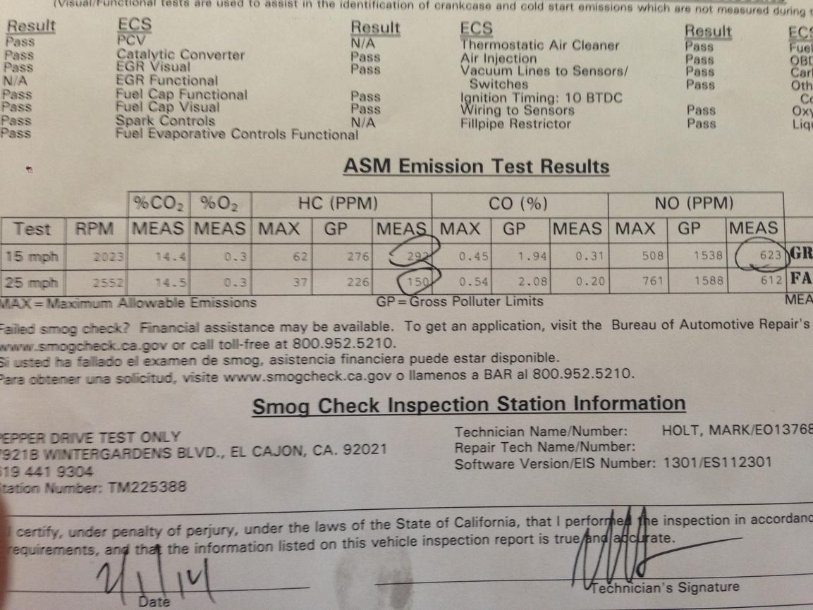

So my 1995 4runner 3.0 wont pass smog in CA the emissions are to high, i have bought
Cat
Air filter
Fuel filter
radiator
tps
cleaned EGR
Both o2 sensors
spark plugs/wires
distributor cap
distributor rotor
MAF
fan and fan clutch
all new belts
timing is on point
and i also have bought CRC stuff and they say its guarantee to pass emissions, i will be taking it in tomorrow to see it will pass, this is also my thred time trying to get it to pass smog, he is also saying there is a little miss fire when your on the gas but i dont see it when i drive it.
And also in the morning around 7:30am its about 50 degrees outsides, maybe a little warmer, but i have to kept my foot on the gas around 2000 RPMs for around 6-8 mins long, and if i dont, the truck dies and it wont start for another 10 mins, any suggesting? thank you
