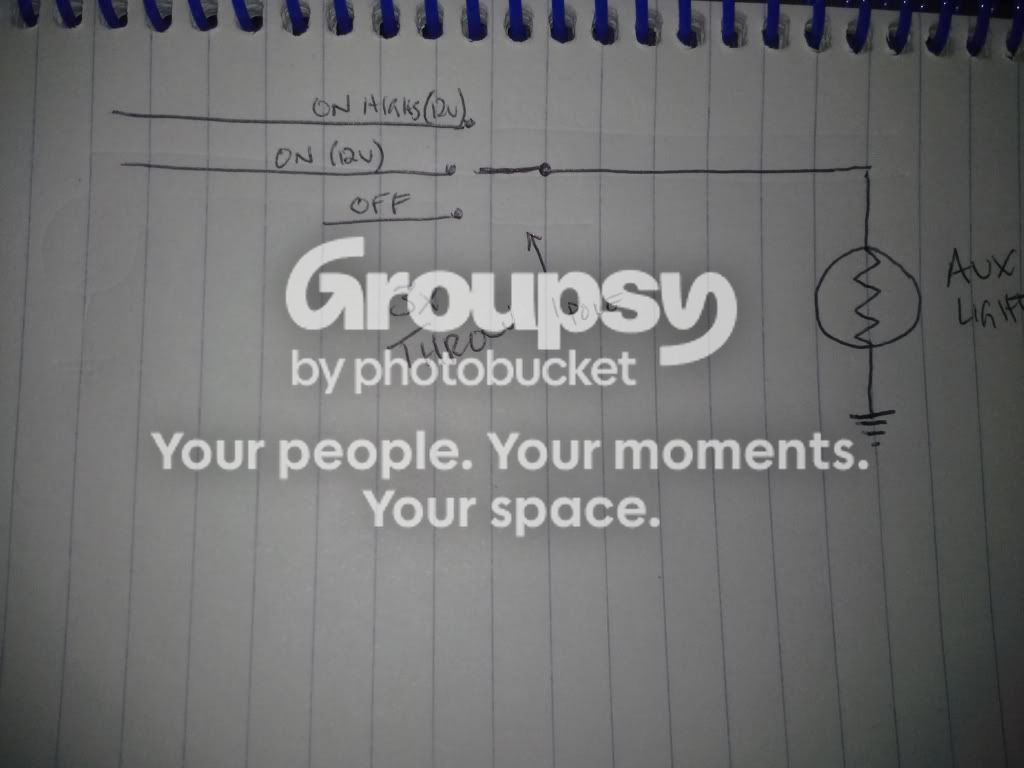

SP3T ON-ON-OFF
It's one of the 2 in the link below. The top one just has the LED wire independent of the input power.

SP3T ON-ON-OFF

On your image that you drew, what is the "3x THROW" mean? Do I need a relay or something there?
Thanks a ton, man! It is much appreciated!
