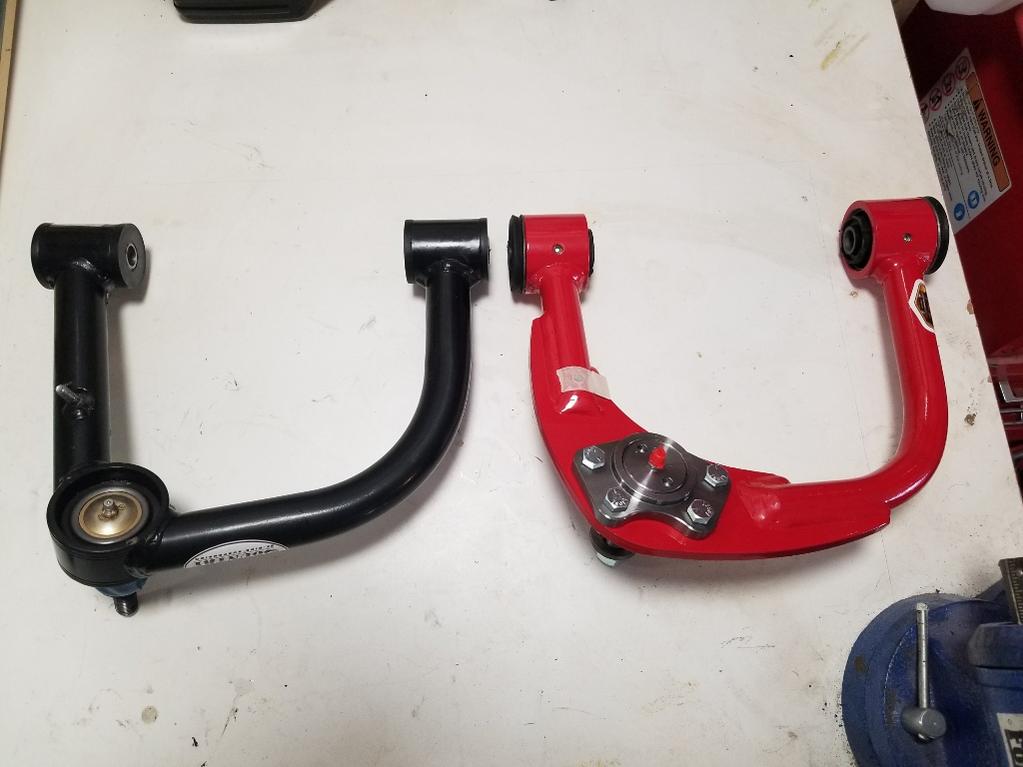

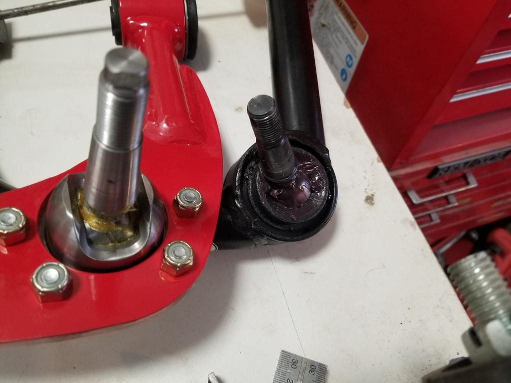

So... I ended up swapping them out this weekend to JBA control arms. And I took some measurements in the process. There are some significant differences between the two arm geometries.
Also I did my first DIY alignment on an IFS truck - I couldn't get an alignment at any shop - they're all days or weeks out on wait time. Some days it's just a walk in, but we had our first snow so everyone is jamming up the shops with snow tire swaps. I think I can build an excel spreadsheet for anyone who wants to do home DIY alignments, but it won't happen today. Don't have time. My plan is to make a spreadsheet that all you have to do is enter the angle measurements and it'll do all the calculations to tell you what cams and how far to move them. Give me a few days and I'll post it up when it's done and working. This is something you can do with a cell phone and a bracket. More to come on this. It's not as accurate as a laser rack, but it's close enough to get it on the road.
Anyway back to the arms.
The big benefits of the JBA arm to me are the use of rubber bushings - same as OEM arms. No noise. They do limit travel and may not work great with extended travel. I'm not sure. My 4runner is a daily driver first, so what's good for me may not be best for you. The ball joint is not OEM style, but it's bolt on - so it's easy to swap, and it should be low maintenance. JBA standard arms use Moog brand ball joints IIRC. Tough Country uses Mevotech. The JBA Moog joint has a MUCH better boot. The Mevotech is a tacoma joint so it doesn't fit properly in a 4runner taper (the taper angle is right, the seat in the 4runner is larger meaning the ball joint sits deeper into the spindle and then the boot is all messed up. Plus it doesn't fit correctly over the joint. The Moog has a soft silicone type that covers the entire joint and comes with a spacer washer that pushes it up the joint to totally seal it in. Neither are as good as the OEM toyota joint and boot though. The Toyota joint has an accordion boot with a spring loaded ring that holds it in place. There's a reason OEM toyota joints last a quarter of a million miles.

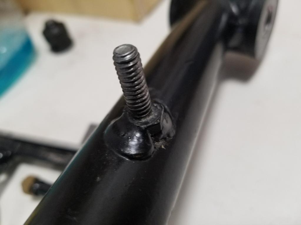

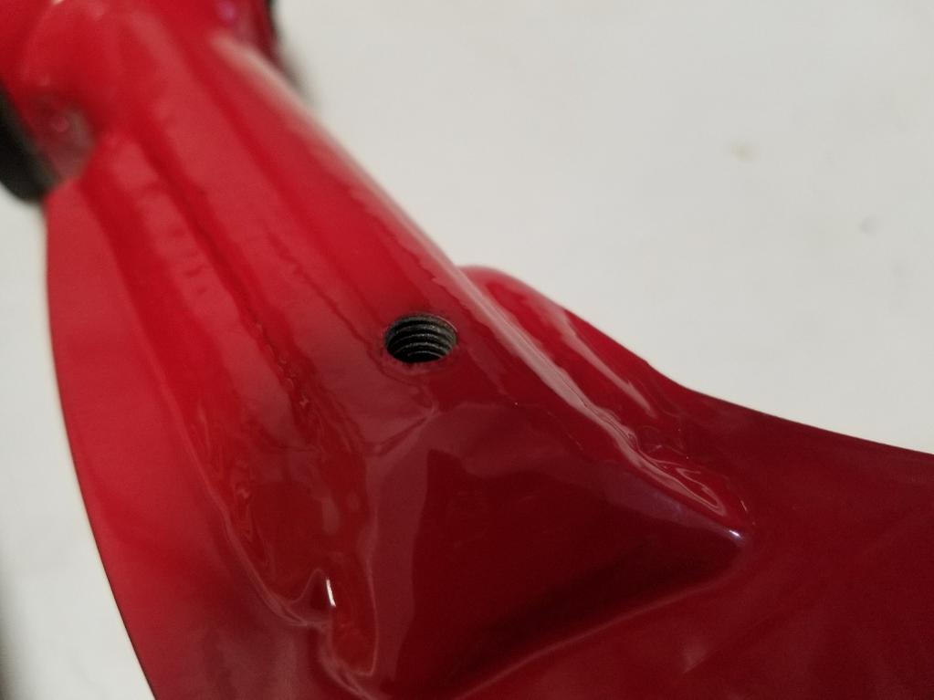

The JBA arm has a threaded hole for the ABS wire bracket. The TC has a crudly welded on bolt - that is the wrong size and you have to drill out the bracket to fit. The hole is 6mm and TC uses a 1/4-20 bolt that is 6.4mm OD. You can jam it over and work it into place, but it's a PITA.
The TC bushings actually have a tighter tolerance fit than either OEM or JBA. The ID of the bushings are a near perfect slip fit, where the JBA and OEM arms have approx 0.5mm of additional clearance. IMO this is a win in the TC column.
Finally TC uses larger OD tube. It's approximately 1.5" OD, where the JBA arms are using 1 1/16 OD tube. Wall thickness is unknown for the TC arms. I don't think it matters much as there is minimal loading on the arms anyway - and the loads on the tube near the bushings should be almost entirely tension/compression. The bushing area is the weak link typically. I'd guess the two are comparable overall strength ignoring the ball joint its self. Interestingly IMO the EBA UCA's that I broke - had the strongest overall design in the arm its self if you ignore the total crap hardware they sell them with.
Final thought is that JBA is missing an easy opportunity to make these better. They should re-draw the outer steel plate to cut 2 or 3 locations to bolt in the ball joint. They could easily be re-designed with almost no additional cost to allow adjustability in the upper ball joint location just by having one or two additional bolt hole sets cut into the pattern. I also don't love the fact that they use a nylock style nut rather than a castle nut with a cotter pin. It's kind of a PITA to install with two wrenches to hold the ball joint in place while you tighten the nut. Also I think there is a safety benefit to using a cotter pin. Both probably work well, but I will likely drill a hole and use a nut instead the next time I do any work on the suspension.

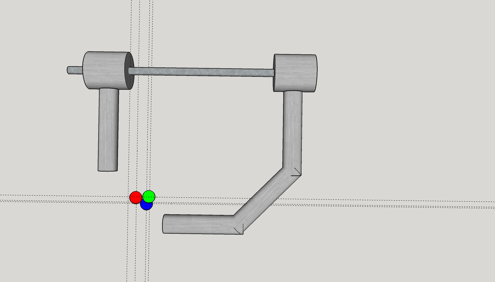

And - here's some hard numbers on the arm geometry. The TC arms would be just fine and a decent value for the price if they would just correct the geometry and use a correct ball joint for the 4runner.
I measured with reasonable accuracy - although actually getting the perfect center of the ball inside the joint is tough and I'm sure there is some error in the measurements. However the relative position is close enough to show the difference.
In the pic I plotted the location of each arm. Green is OEM, Blue is TC and Red is JBA. The TC arm adds approximately 5mm of longitudinal adjustment relative to the frame (meaning caster) and adds about 7mm of lateral (camber - moving the point away from the frame). The JBA arms adds 22.5mm of caster and is approximately the same camber. The result on mine was that the TC arm could not get camber into spec and left caster worse than before due to maxing out the cams on camber setting. The JBA I have not had on a rack, but based on my DIY aligment I know camber is in spec and I should get to about 4* of caster.
The TC arms probably work with about 4 inches of lift to put camber in spec, but do nothing for caster. The shorter UCA means as you go up camber goes down. At 2 inches of lift they're not usable. They probably don't work for either scenario very well on a 4runner. Maybe they work on a Tacoma? I don't know.
Also just for further info - the dots look close together, but the difference is important. The geometry of the JBA arm adds about 6 degrees of caster. The TC arm adds approximately 1.5. However because of the other issues with the camber I ended up with LESS caster net. The JBA arms should allow you to re-center your cams and still get caster closer to 4. So with a lift I think it'll still be able to end up with 4 and not have to totally max out the cams, meaning you can actually get a good all around alignment.
