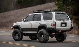

So if I'm wanting to lift my 99 3 in's with bilstein shocks front and rear. Which do I get??
The 5100 tundra shocks. The 3" lift depends on your spring. Search and you'll find TONS of info and other possibilities as well but I have no problem with my tundra shocks with my 890/ TRD tundra spings

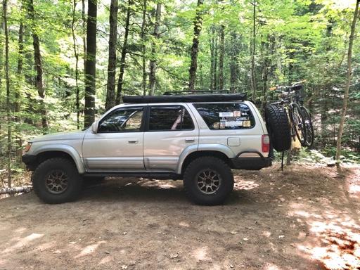

I have tundra 5100 rears in mine and they’re way too soft, especially now that I have a rear bumper with swingout & 33” spare tire on it.
Even before that though I got a ton of bounce on the trails, don’t recommend
Thank you, that's very helpful and the exact reason I was contemplating the LC/4th gen shocks (also plan to get a swingout bumper, myself). What coils do you run? I'm thinking 891s
I have 891’s along with Firestone airbags. I have a pair of black Tokico LC shocks that just came in a few days ago that I’m ready to swap in.
Also considering going to 861’s because even with the airbags at 20 psi I was still getting some sag when loaded with camping gear & bicycles on the 891’s
I do wanna try the LC shock + 891 combo first though to see how it rides before I switch to 861
Do report back, would love to hear how they feel, especially with LT/E rated tires. Really trying to be cautious as to not inadvertently make my car stiff as a board
Put them on today - first of all F**K Toyota engineers for making the shock mounts so goddamn hard to get to. 2nd - F**K bilstein for making the 5100 without a body on the upper portion so there’s no way to grip it.
Anyway - I only got to drive it for 2 miles, but I can already tell they do WAY better at keeping the rear suspension under control. Will report back as far as overall ride quality goes.
