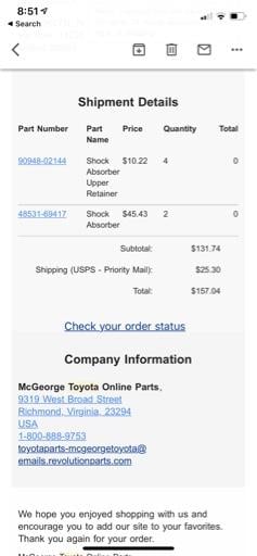

48531-69417 is the p/n, correct? Might have to take a look into these since the LC/4th gen Billies (and most of their other products) are on back order currently and have been for months. Sounds like the very similarly valved, if not progressive, which would be nice
This is what I got
I read in another thread that they are needed, they’re expensive for what they are, but for ease of install I went for it
Well I ironically forewent them for that exact reason; couldn't find any other mention of them. Hopefully I won't need them - McGeorge is being awfully slow recently.
