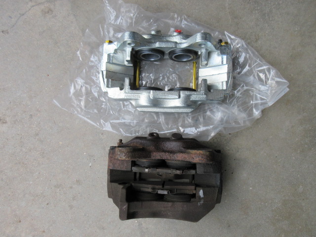

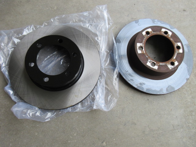

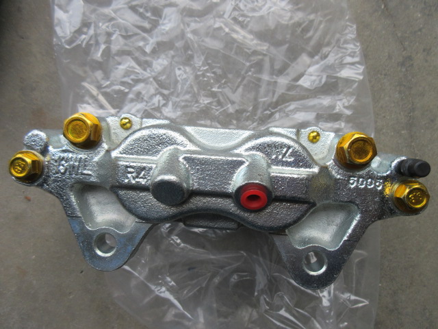

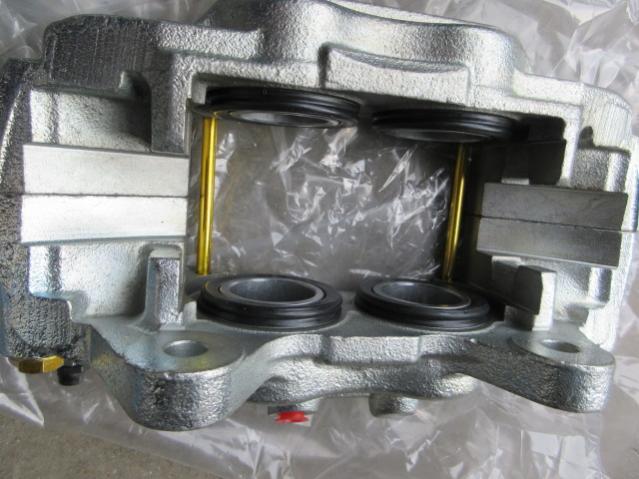

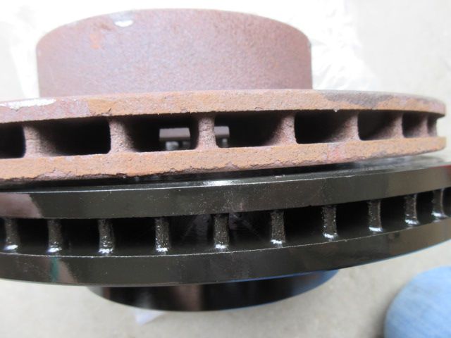

Was looking around for some good quality parts options on the Tundra brake upgrade. I was talking to my Toyota dealer parts counter guy. He recommended Automotive Brake Warehouse, a brake specialty place local to me in Massachusetts.
If anybody has installed some top quality TBU parts, lets us know.
Here is what I went with (2005 Tundra V8 4x4) -
DFC (Dynamic Friction Company) - 13WL 231 mm calipers, reman, looks like a good quality build, zinc coated with nice hardware.
Centric - rotors, nicely painted in the non pad areas
Centric - ceramic pads
Operation is good, long term use will determine my full approval. Anybody else use any of these?

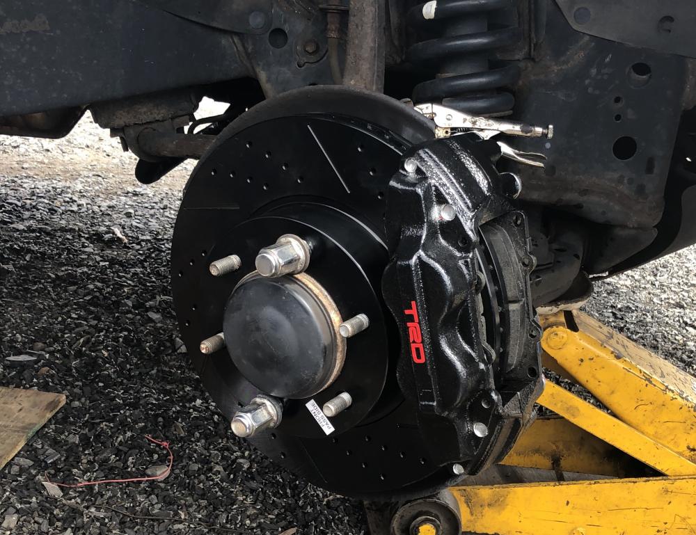

Bigger brakes
That’s my set up
