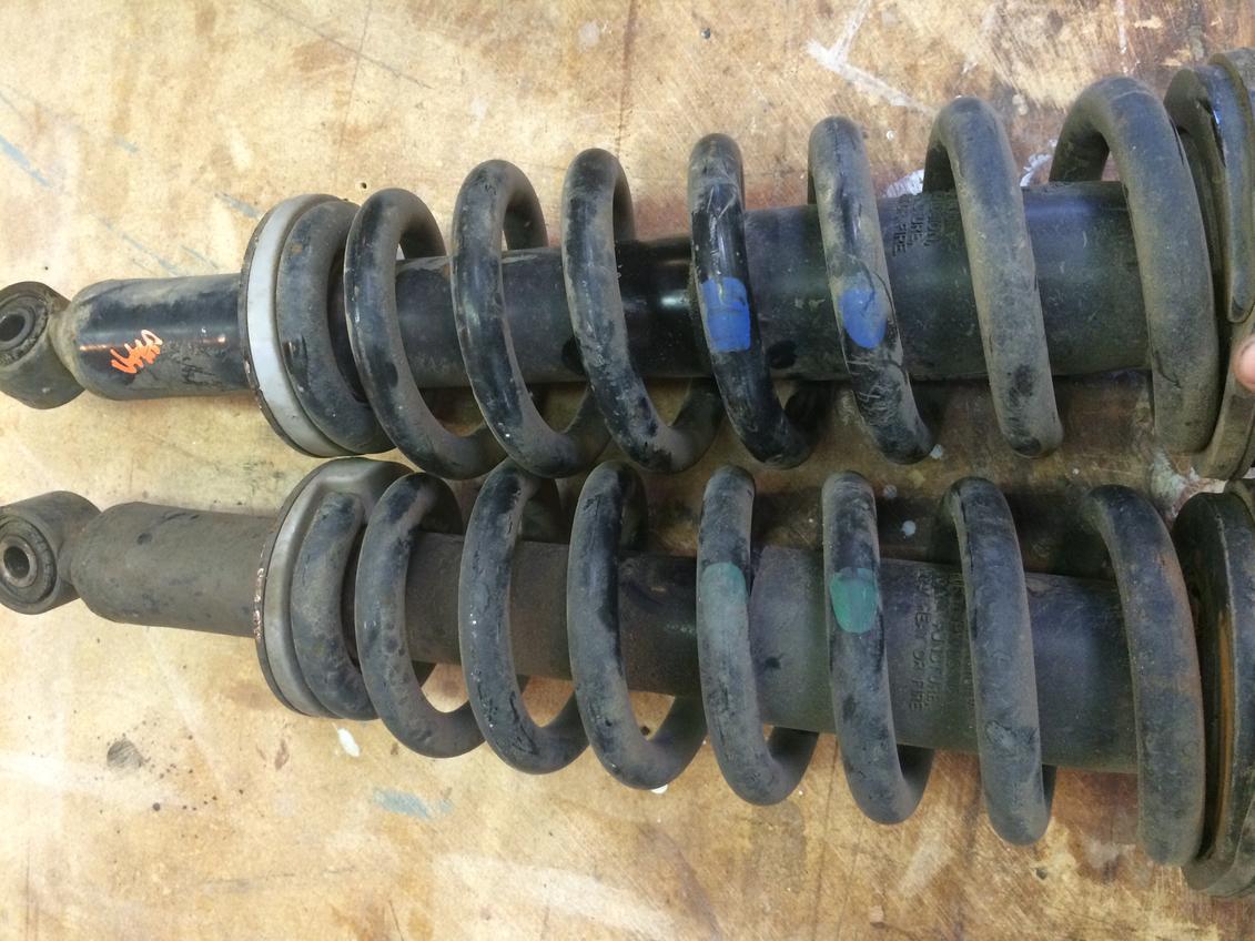

Alright guys. Here are some pictures of the springs. The colors are blue,blue and green, green. image.jpg

I have the non-TRD coils on bilstein 5100's and they are totally fine. You DO NOT need the TRD coils like everyone seems to think. They give the same ride height. The only difference is that the TRD coils are supposedly progressive wound coils and give a better ride. I am more than happy with the ride of my non TRD coils and I think it has more to do with the shock anyways.
I ran the stock tundra struts before I got my bilstein 5100's. They worked well but I ran them with a 3/4" top plate spacer. And as mentioned, you need to transfer over the coil isolator/top cap from your 4runner so the studs line up.
With the 3/4" spacer, they gave me about 2.5" of lift, if I remember correctly.
With the tundra coil and strut on its own, expect 1.75-2" of lift over an average stock height.

Thanks for the info. There are so many different versions of Tundra and a lot of them have different shock setups so it gets a little confusing trying to figure it all out. I assume these aren't TRD because it seems like all the TRD shocks have different color markings and yellow struts. Is that correct?

I think I've figured out that these are from an 05 Step Side, 2X2, TRD Sport Package
Drivers side front coil Green/Green
Passenger side Blue/Blue
Hoping that since it's a TRD even though its a two wheel drive that it should ride the same as the Yellow/Blue TRD coils everyone seems to be running.

TRD springs are Yellow/Yellow - Yellow/Blue. So you are correct in that they're not TRD's. If there's two versions of the TRD springs, I'm not aware of it. I don't know everything though. Fact, I don't know much sometimes. It's not that everyone thinks you NEED to run TRD's, just that if you're going to spend money on them new, get the one's that ride better. Find some in a yard? Take what you can get.

I always thought there was only one TRD coil as well. But I checked and the vehicle I pulled these off was a 2 wheel drive TRD. And I found this Tundra TRD Owner Roll Call... PLEASE READ!!! (coil springs) [Archive] - Toyota Tundra Forums : Tundra Solutions Forum which confirms.
