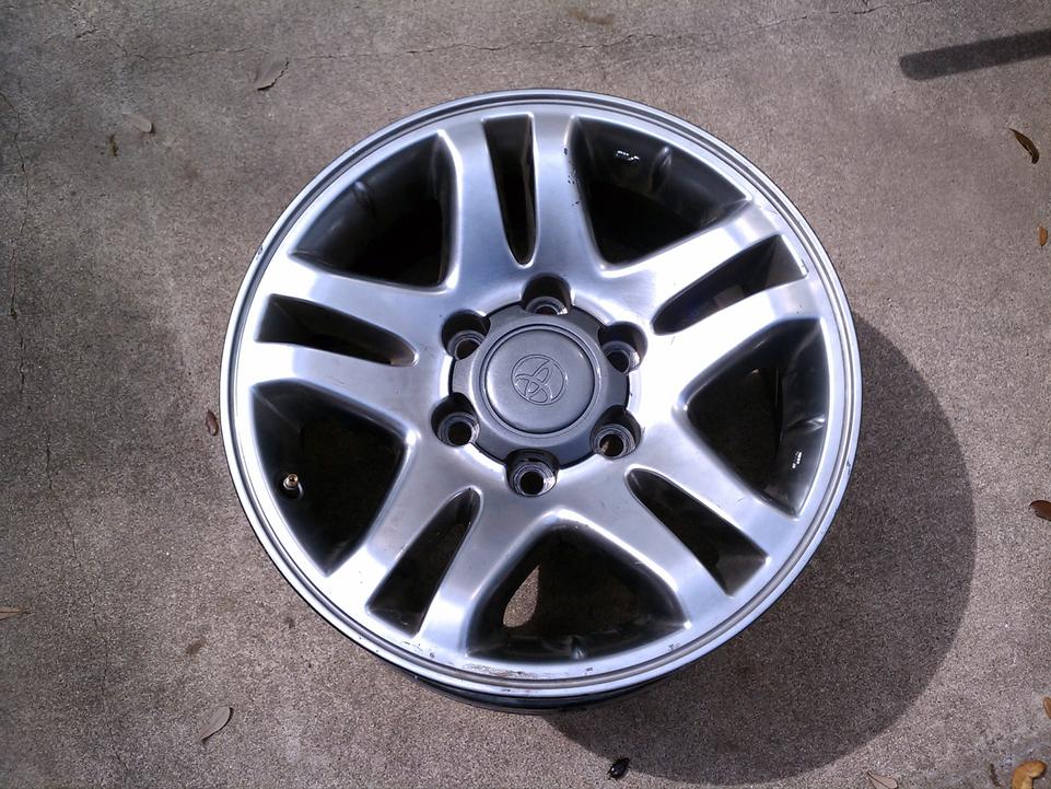

You're not the only one who does this. I bought some Sequoia wheels and immediately broke 3 tabs on those stupid caps when I pulled them off the wheels. I did discover that the center caps from the stock 5 stars from the 4Runner will fit on the Sequoia wheels. The 4Runner caps have metal tabs that I have never broken. I'm going to do this as I plan to paint my Sequoia wheels.

Here's the 5-star center cap on the Sequoia wheel. The cap has been painted, but the wheels haven't yet. The spaces for the lugs don't line up exactly, but the clips don't break when I take cap off.
