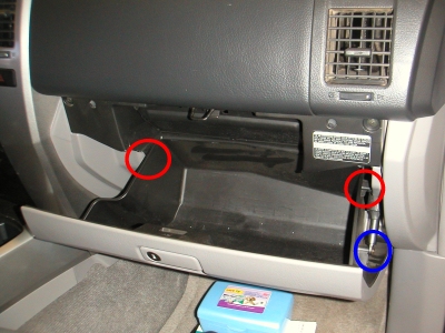

How to access the cabin air filter?

The cabin filter is behind the glovebox. In order to get it out you must pull the glovebox off, and behind there on the bottom is a black tray thats clipped on you release those clips, and theres one screw, and bam theres your filter in there. Sorry if that was unclear :redbrick:
Mine is a white tray.
Don't worry your description was so great it scared me. I think I might leave that one to the dealer I don't want to break the glove box.

The dealer will charge you an arm and leg for a 10 minute job.
Open glove box. Remove screw circled in blue. Push tabs inward circled in red. Then the glove box will fall further down. When it goes down, you'll see the white tray.
