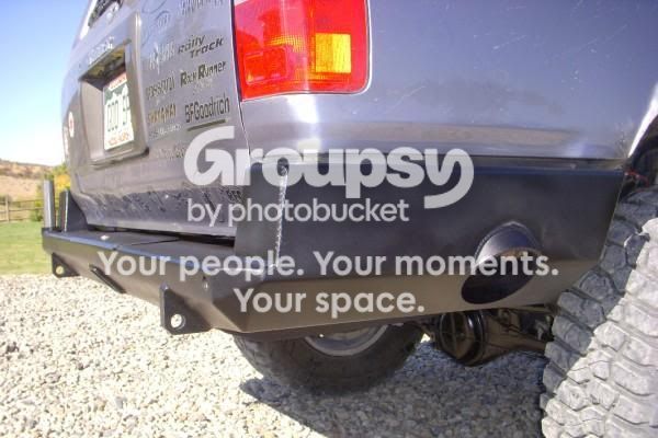

You are correct, there isn't any exhaust after the turbo yet, but there are plans to do it like this. We just need a plasma cutter to do bumpers.
